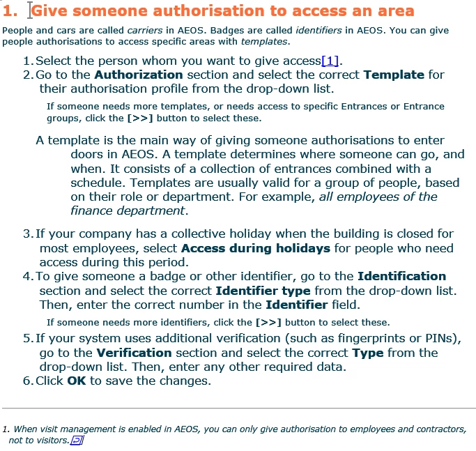

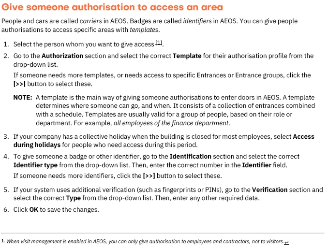

I would love to go through Word. It should give more control. I did it rather successfully back in the day using RH9. However, in RH2019 new UI, it is just unusable at the moment. See the attached screenshots, one for the PDF output, one for the Word output.
Note: I have mapped all styles correctly into the Word template styles.
In the PDF output, see the consistent font size? See the consistent indenting? All the bold text comes from a character style. Wonderful.
In the Word output, see the different font sizes? See the weird indents? And except the heading and the footnote line at the bottom, every single line is style Normal + direct formatting. The bold is also direct formatting, even though the character style has also been mapped correctly.
There is no control whatsoever, and I'm not going to edit 200-odd pages like this. I'd rather take my losses and use the limited PDF output with its broken up tables and headers. I wonder if anyone is using the Word output from RH2019 New in a production environment. I'd be very interested to see how they do it, because I wouldn't have a clue how to do this without massive editing in Word afterwards.
