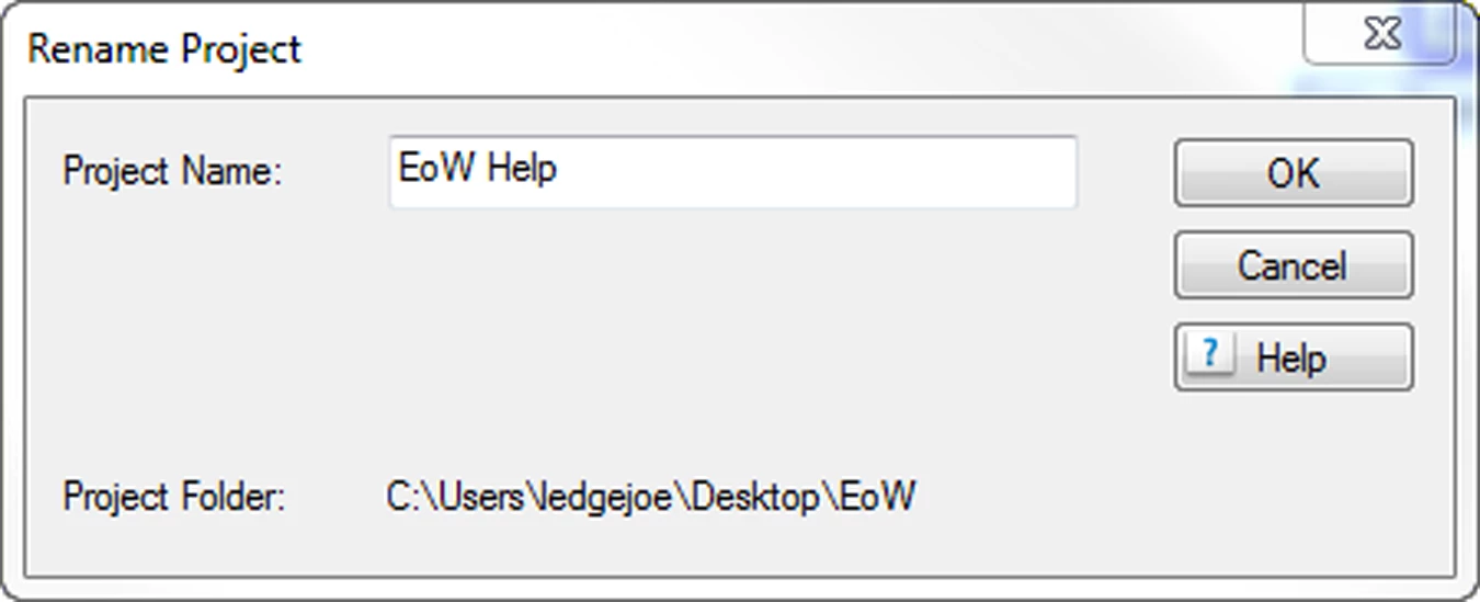

I was sort of expecting to see that your project was stored on a network drive. But the dialogs reveal a different story. The only thing I might suggest would be to create a folder named Projects right off the root of your C drive. ( C:\Projects ) and place each project inside its own folder there. In your case it would appear to be: ( C:\Projects\EoW )

Can you please click File > Rename Project so you see the dialog and screen capture that? Post the image here in the forums for us to see.

November 15, 2011
Here's the first one...
And the second...
