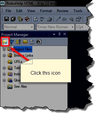

Hi there
You aren't losing it. Likely you just changed the view of the Project Manager pod.
Try clicking the icon shown below and the Baggage Files folder should perform a re-appearing act.
Cheers... Rick

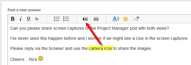

Can you please share screen captures of the Project Manager pod with both views?
I've never seen this happen before and I wonder if we might see a clue in the screen captures.
Please reply via the browser and use the camera icon to share the images.
