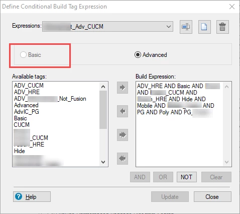

All of my conditional build tag expression definitions in my HTML5 outputs have been switched to Advanced (I was only using Basic before) and I can't switch them back. Not only that, they're wrong.
In the picture above, the red box shows that the Basic radio button isn't active.

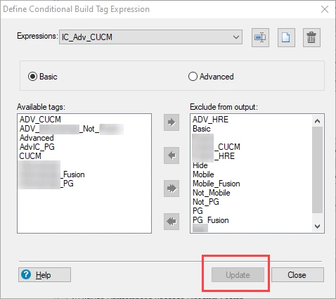

In the picture above, the Update button never becomes active for the new expression.
In fact, trying to update the conditional build tag expression for any existing output won't work. The Update button never becomes active.

So, in all of my existing outputs, all of my conditional build tag expressions are using Advanced, they're all wrong, I can't switch them to Basic, and I can't apply a new expression.

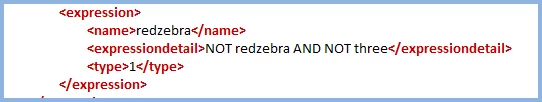

    The expressions are in the rhbuildtag.apj file and a basic expression looks like this.
    It starts NOT sometag and continues AND NOT othertags. Anything else is Advanced.
