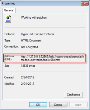

Im using RH9 to create help for use with an Eclipse plug-in. I'm using the EclipseHelp Generator.jsx without any issues. The problem that I have is probably very fundamental but I haven't found any answers so far: I would like to include a hyperlink in one of my topics to an Eclipse help topic that exists outside of my project. I thought I would simply copy the URL that i see in the target topic (found via Properties for the target topic):
Obviously, I have been very naive. I understand now that the IP address indicated here is in fact a Loopback Address, which is useless for creating a hyperlink.
My question is, how does one create such a link? That is, what address information can be used instead of the Loopback Address that will allow such a link to work?
Am I barking up the wrong tree entirely? Any help would be greatly appreciated.

    I am in fact using Insert --Hyperlink and pasting the URL for the target topic in the "Link To" field. I believe the issue is that RH cannot resolve the URL, as it uses a Loopback Address ("127.0.0.1...") rather than a proper URL.
    Ideally I would simply indicate the path for the appropriate topic here. My question is, how does one determine the path and file information for individual Eclipse help (HTM) topics?
    I assume that they are contained in the various JAR files that is see are installed with Eclipse (i.e. "org.eclipse.help.base_3.6.2.v201202080800.jar", "org.eclipse.help.source_3.5.100.v20110426.jar", etc). There are lots of these, plus lots of other ZIP files and all kinds of myserious stuff that is installed for Eclipse. I would have to establish which file contains the HTM that I need, and somehow extract the HTM file. It all sounds improbable now that I've figured out that Eclipse does not use collections of HTM files, but seems to package them in JAR files...
    It occurs to me after messing around with this that I may be on a bad track. I wonder if it would be problematic (even if possible) to link to topics that exist in external plug-ins. I guess the link information could change if the external plug-in is updated, which is of course beyond my control.
    Thanks again for your answer!
