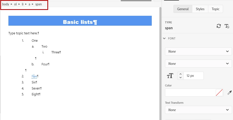

    Huh. I didn't know you could double-click the link. 🙂
    @martinl83372021 the way I got the panel to display was selecting the link. However, just putting the cursor inside the text, or selecting the text won't always show the correct panel, depending on what inline formatting might be applied. So I use the breadcrumbs bar at the top of the topic interface, just underneath the tabs.
    For example, here when I click in the link, only the properties for the span tag display. To select the link I would click on the "a" in the breadcrumbs at the top of the topic. (These breadcrumbs are describing the underlying html stucture.)

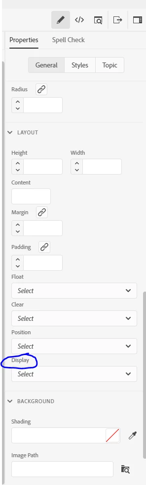

    Oct 8, 2020 6:09 PM UTC
    Hi, Amber and Jeff, thanks for your replies.
    Amber, I don't quite follow. I don't see "Display in" in the Properties panel. I do see "Display" under "Layout" (screenshot). But that doesn't seem like what you mean.
    Where in the Properties panel should I be looking?
    SCREENSHOT:
