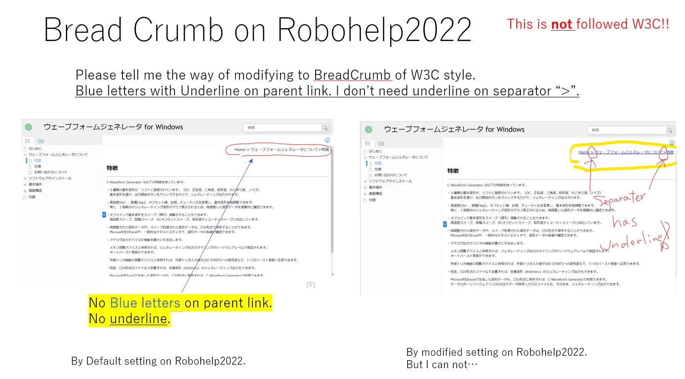

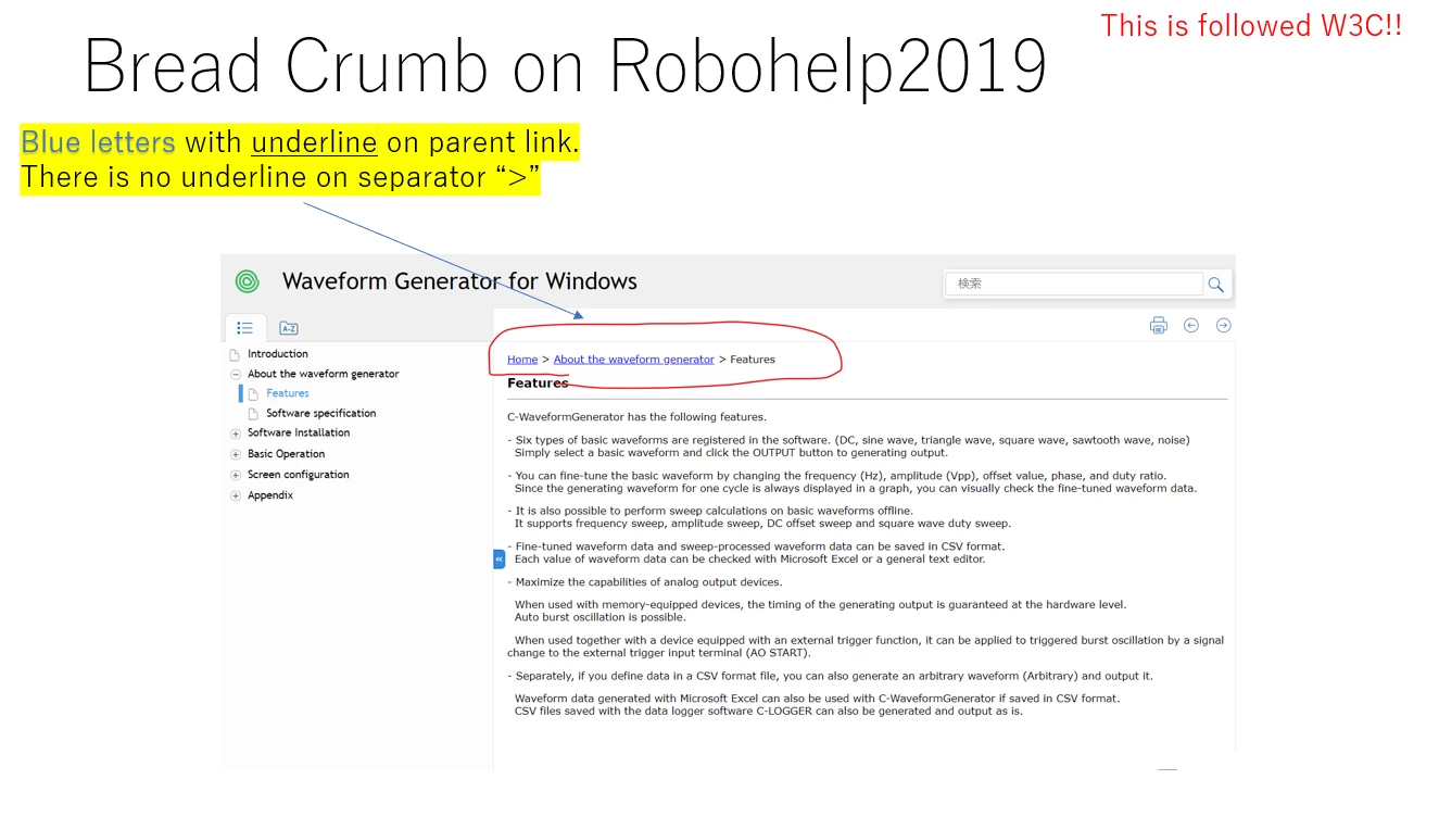

Here is BreadCrumb on Robohelp 2019.
Here is BreadCrumb on Robohelp 2022.
And I can not same style as Robohelp 2019 even though I modified the robohelp settings.
I can change the letter color from black to blue and add underline.
However, I don't need underline on separator ">".
How can I do that?
Please see the attached pptx file to know more details.
Thank you.

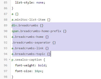

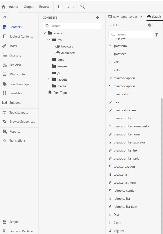

    Okay the breadcrumsb styles aren't added automatically to existing stylesheets. What I recommend is that you create a new, temporary project. This will create a new project with two stylesheets in it: book.css and default.css.
    Open the default.css file. You'll see it has a bunch of default styles already added.
    In the top right of the window click the </> (Source) icon to switch to code view.
    Copy the styles that contain the word "breadcrumbs". They should be all together in a fresh stylesheet: I've highlighted the list I can see. Make sure you include the closing curly bracket }; it could be on a separate line so double-check.
    In your real project, open your topic stylesheet and switch to code view. Scroll right to the bottom, press Enter after the last curly bracket }, then paste the breadcrumb styles.
    Now you can switch back to the Author view by clicking the pencil icon and edit the breadcrumbs-link style as usual.
    If you find you need the other styles (e.g. if you use a mini-toc/topic toc or see also button) you can copy those styles in the same way.
    See how you go with that.

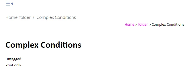

    I decided to take a quick look again so that I could get the issue in my mind and ponder it.
    I created a topic layout with breadcrumbs and got this.
    Then I went back to your original post and saw what you want is coloured text and underlining. Both should be straightforward although I have not tested that. That's when reading again I realised the difficulty is having a separator that is not underlined. Something like this where I have cheated it with Snagit.
    I very much doubt that can be done but if it can it is beyond my skills.

    Jun 19, 2023 7:33 AM UTC
    What you've done in your screenshot is apply the styling to the entire breadcrumb "div" tag.
    What you should find is that a "breadcrumb-link" style has been added to the stylesheet applied to your topic layout. At least, I found those styles added to the only stylesheet in a simple test project. You should find a few other breadcrumb styles added to it as well, but I don't think you need to change any of the others.
    Have a look and see what you find.

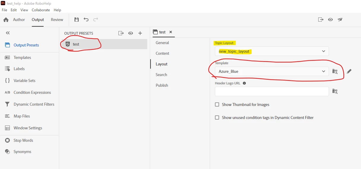

    Jun 19, 2023 1:12 AM UTC
    Hi, Peter,
    My icon shows "5" on "OUTPUT PRESETS".
    It is same situation of breadcrumb (no blue letter and no underline) even though I create a new project on Robohelp 2022 by default as below.

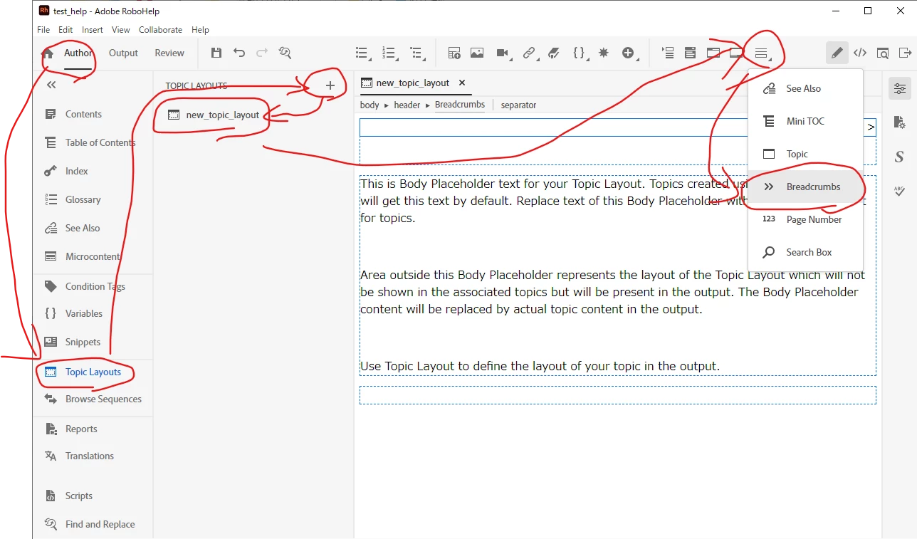

    I add "Topic Layouts" to add breadcrumb on my topic_layout on header.

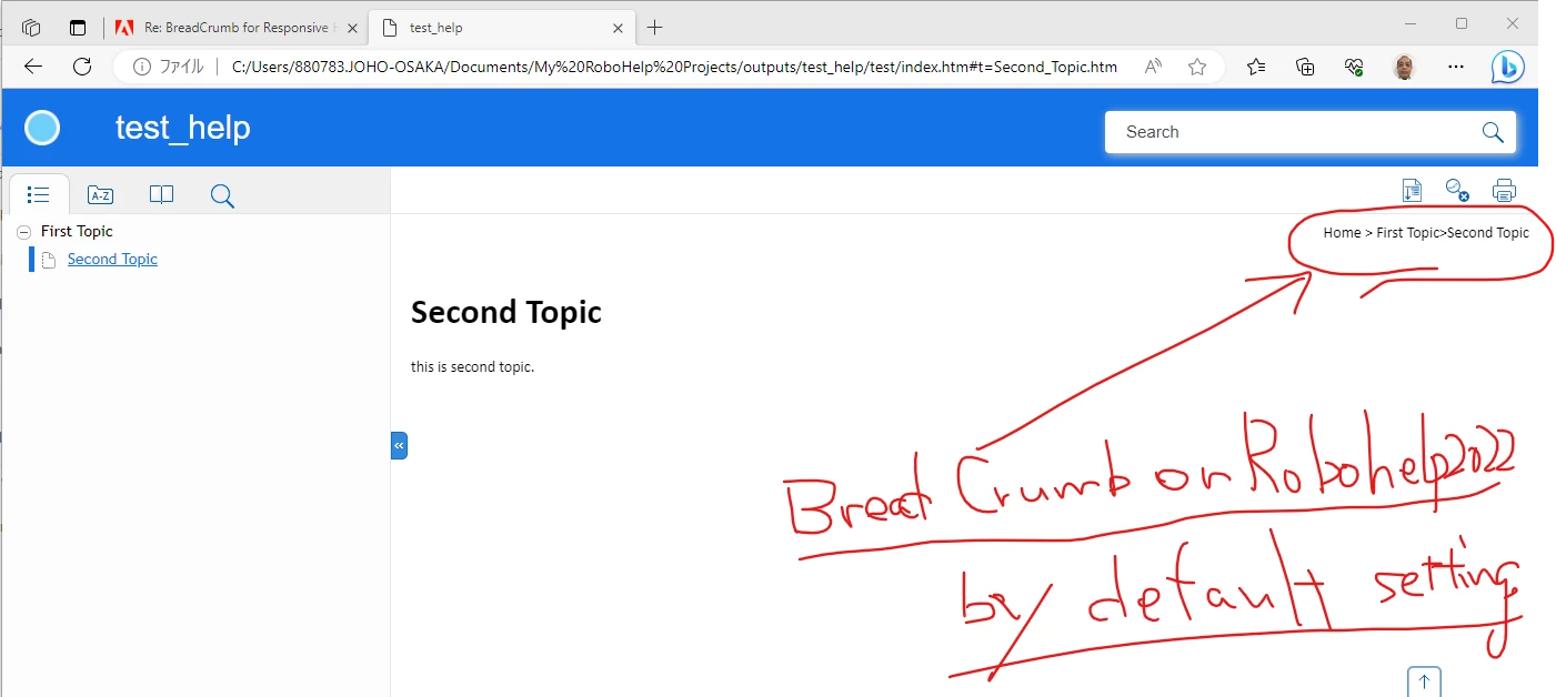

    It is black letters without underline on bread crumb by Robohelp default.
    Here is the default bread crumb on Robohelp 2022.

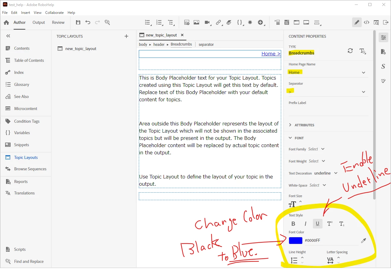

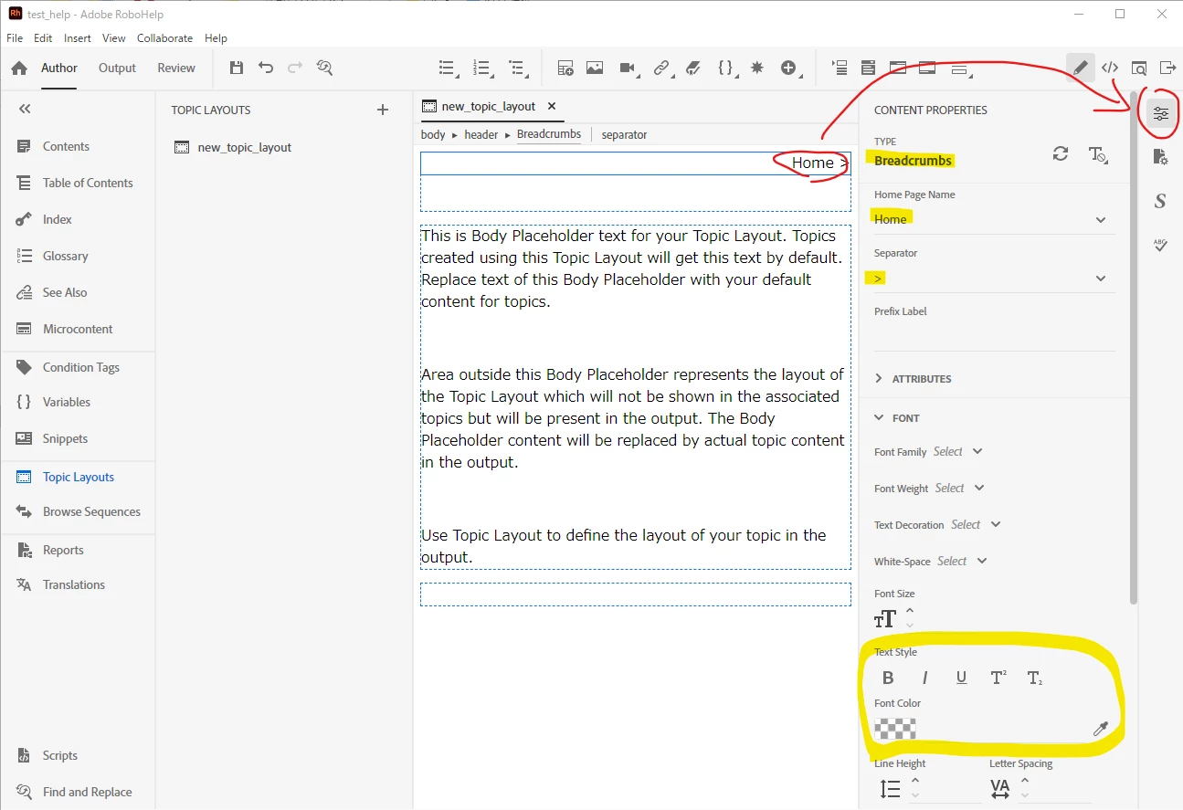

    I need blue letters with underline on parent link. and I don't need underline on separator ">".
    Thhen I change the letter color from black to blue and I add underline on bread crumb.
    However, the underline is on seperator ">" as well.
    Nobody can not realize there is "parent like" on bread crumb.
    It is no good for my customer.
    Here is my setting on bread crumb.
    And This is my appearance.
