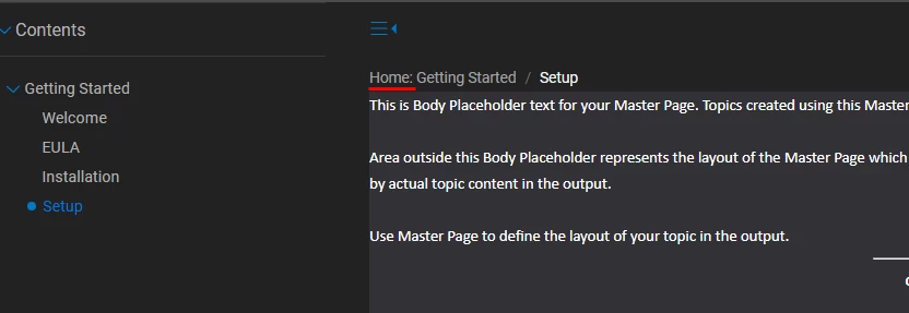

Good morning ladies and gents,
I started a new project with the Frameless Dark skin this week, and I've run into a problem.  I'm not sure if it's a common issue or if it's just me, but it seems like the breadcrumbs Home button/link is broken.  It keeps taking me back to a topic that I no longer have in my project, the First_Topic.htm topic that is the default topic when you create a new project.  I have tried to find out where I can edit the information for that topic, but I can't find it.  When I click it here, it just gives me a broken link error, because obviously the topic doesn't exist.  I want the button/link to take me back to the home page for the project.  It's the Home link/button I have in the attachment.
Can someone please assist?  If I click the Title bar/icon it takes me back to where I want to be without an issue.  Ideally the Home button/link would do the same?

Go to the Output Presets.
Open your Online Help preset.
Open Content, the second option down.
In Default Topic, select a HTM file that you want to be your homepage.
Save and regenerate the help.
Did that work?

Jan 28, 2020 11:03 AM UTC
Hi @ivanw65285818, it actually didn't work, but your suggestion did make me look at an option that helped me fix it.  I don't know why, but just entering index.htm into the Default Topic section under the Frameless output didn't work.  I tried that numerous times, but it simply refused to work.  I then navigated to another topic, selected that and it did take it as the "home page".  I then again erased the default topic box content and manually entered index.htm and boom, it worked this time.  I guess somewhere something got stuck on the backend on the default topic name.
Thanks for the help mate, it's working just fine now!
