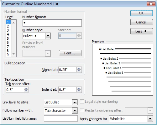

I am imported Word 2003 documents into RH8 and my bullets and numbered lists are not aligning correctly. Both are custom styles configured via Outline Numbering and work fine in Word. After importing, each bullet/number has an extra space on the first line so subsequent lines are not aligned.  When I reviewed the CSS, the entries for these styles all have a text-indent of -.25, which I am assuming is wrong since the Word ListContinue styles (which display correctly) do not. I pulled the HTML line out of the CSS but everytime I import again, it is reinserted into my custom CSS.
I have attached a screen capture of what it looks like in RH.

Your settings in Word are below and I suspect the extra indent could be resolved by playing with the Bullet Position and Text Position settings. Also try changing the space after from Tab to Space. Tabs are not an HTML concept.

I had tried changing the Tab to Space, which disables the Text Position
field, but that didn't work either. I tried that a while ago so don't
recall specifically what happened on the RH side.

There are a couple of reasons why we use the List styles created  by
Microsoft for Word. Using styles keeps the documentation consistent
between all writers and more importantly, when a format is changed, you
only need to change the style once in the template and all the doc is
automatically updated. With inline styles, each instance would have to be
manually changed.
I did try creating a RH Lists style and also tried doing a Multi-Level
Lists style within RH but that proved painful. But I was not linking the
style with the before-mentioned List check box for RH Lists. I will have
to look more into that.
