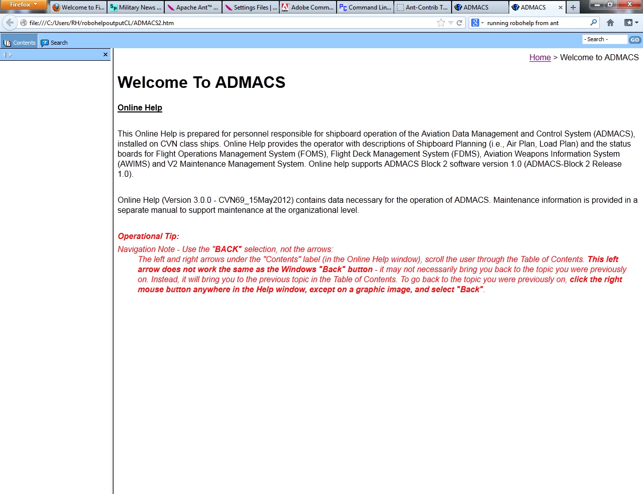

    Hmmm I am not making assumptions. I am posting my frustration based on my emperical tests. But thats neither here nor there. I thank you for the link to Bills page ... I have memorized it already reading and re-reading it over the last several days. I converted the command line I use to "RHCL myproject -lmylayout" just to make sure I am using the same layout. Where "mylayout" is the same layout I am using in the IDE.

    From the command line:
    Screen Shot:
    Log:
    dobe (R) RoboHelp Project Command Line Compiler version 9.0.1.262
    Copyright (C) 2006-2007, Adobe Systems Incorporated and its licensors. All rights reserved.
    Project: C:\CM\cm_sandbox\BLK2_REL_10611_CVN69_RC\apps\admacshelp\src\Block2\ADMACS Blk2 CVN69 Baseline.xpj
    Layout: WebHelpBatchBuild.
    Output: C:\robohelpoutput\ADMACS2.htm.

    Note in the second snap shot the lack of index and glossary output. Also the menu options at the top are lacking.  Looking at the logs there are alot more update operations being performed in the IDE version.
    So, not assuming that it is broken, do you have any idea what I am missing here to make these outputs the same?
