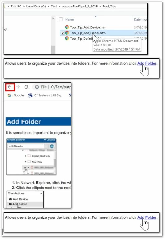

My boss wants this done and I am trying to accomplish this in RoboHelp 2019 HTML. I need to deliver tool tips which need to be only text and no graphics in separate topics except a link to a regular topic with graphics and all the bells and whistles of my main help system. I created a folder called Tool_Tips and have a couple topics that are only text with a single link to full fledged topic (below).
1. I created a separate Output Preset taking everything out including no Master Page and scoped down the skin etc.
2. However, on output I still have a sidebar with search (below). I want the output to just to be text with one link (below Add Device).
Also, when I click on the link in Tool_Tip_Add_Device.htm, I want the FULL topic with images Table of Contents etc. So I save off the Tool Tip files.
3. Then I go back to Output Presets and Output the main Help system.
4. My plan is to save off those files and deliver that separately.
roryj86911642
Mar 7, 2019 7:50 PM UTC
I've got it to the point if I save the Tool_Tips output separate from the output of the whole Help system, and then start from the .htm file (i.e. Tool_Tip_Add_Folder) rather than Generate Preset ---> View Output from RobHelp it seems to work the way I want. I am using a stripped down topic for tool tips and then clicking from there to a full help system file with Master Page, headers, footers, default CSS, TOC, index, etc. Then I click the back arrow of browser (i.e. Chrome in this case) to navigate back to the tool tip. Unless you have a better way of doing this, I believe I want to keep it simple. Am meeting with developers and managers next week to present my solution.
