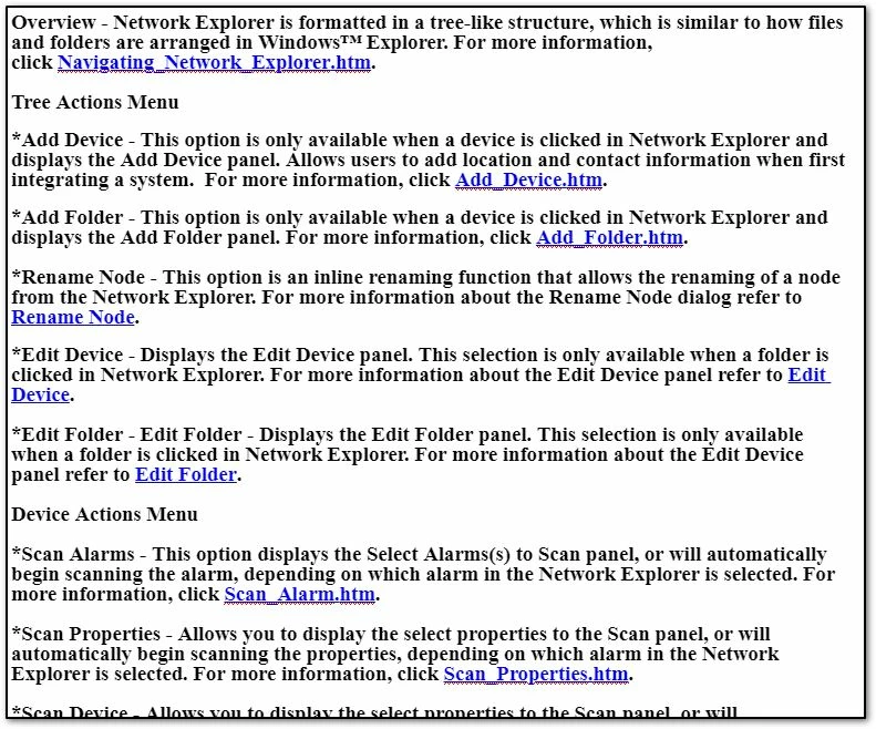

Can I integrate HOVER tool tips to my present static tool tip-to-topic schema?
I am using RoboHelp 2019 version 2019.0.6. I am outputting to Responsive HTML5.
Is it possible to create hover tool tips in RoboHelp that access the same file as the static tool tips? I have presently created two separate outputs; One points to outputs and is the full Help System and the other points to a TToutputs folder containing all of the actual static tool tips. An example of a tool tips topic is displayed below. I am using a stripped down topic for tool tips and then clicking from there to a full help system file with Master Page, headers, footers, default CSS, TOC, index, etc. Then I click the back arrow of browser (i.e. Chrome in this case) to navigate back to the tool tip.
Amebr said in a previous tool tip question when I originally set my system up. She said, "Where exactly are you trying to use the tooltip? Can you describe what you are trying to do, or post a screenshot or mockup? I have another idea, but it depends a bit on what you're trying to do." I did not have the requirement to create HOVER tool tips, only the static tool tips. Now I have the requirement to create HOVER tool tips.
Amebr, what is your idea? Anyone else, have any idea how to do this?
Please help. Thank you,
Rory
