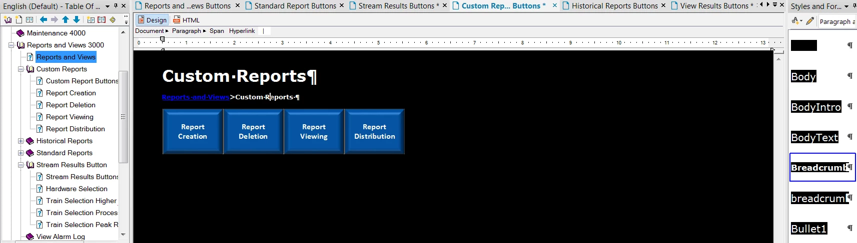

I've attached two images. I created a style, Breadcrumb, for the breadcrumb line, and applied it. Then I highlighted part of the breadcrumb line, and dragged the topic, Reports and Views, from the TOC to the highlighted text. The color I got is a royal blue that does not have any contrast on a black background (just FYI, the people who will view this help will be outdoors in sunlight, so the black background is a corporate directive).

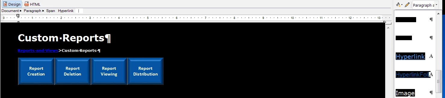

If you look at the second image, the Hyperlink style is a lighter color blue with higher contrast against the black. That's what I'd like to see automatically when I apply a link to existing text.
