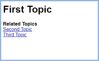

In Classic they appeared like this.

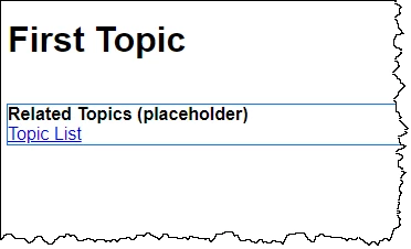

In 2022.4 they will look like this in author view.
In the output or preview they will look like this.
Is that not what you are seeing or is the issue the links don't work?

Aug 11, 2024 3:03 PM UTC
Using 2019 classic, Related Topic output show in a popup (dropdown) menu to select the related topic from. When I tried to upgrade the project in 2019 reimagined and 2020, the results were as you show in the third image, a long list hogging the page, instead of being a single button to select from.
