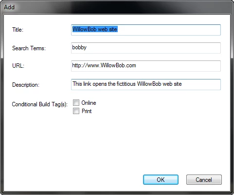

Just to double-check here. You have configured one or more entries in the View > Pods > External Content Search.

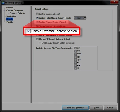

And you are certain that the External Content Search has been selected in the WebHelp > Search settings you see before you generate:
