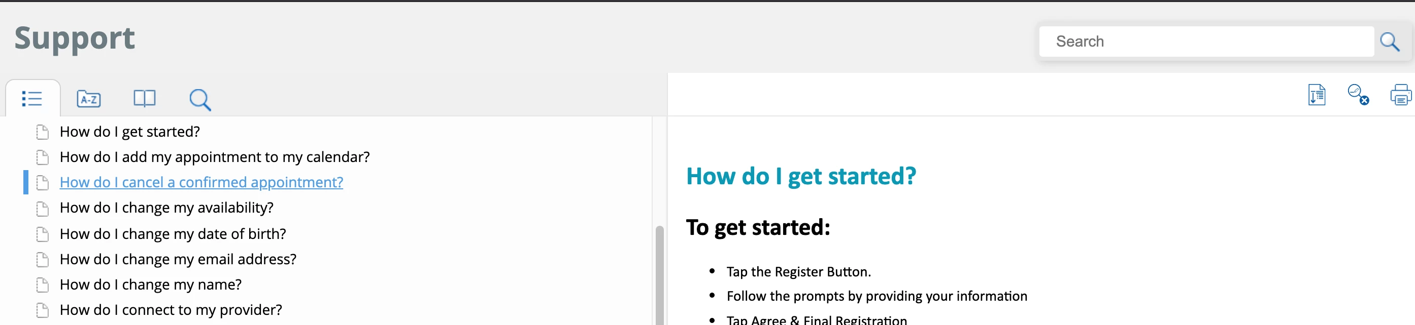

    You have posted I did find out that auto generating the TOC fixed my TOC mis-match highlighting issue. I had to check the box to remove existing TOC and the links are now correctly highlighting with what was selected/clicked as if it is a solution but it seems to be a different issue. Are your outputs now OK as far as this thread is concerned?
    jmcclaineAuthor
    Sep 9, 2020 3:44 AM UTC
    I did find out that auto generating the TOC fixed my TOC mis-match highlighting issue. I had to check the box to remove existing TOC and the links are now correctly highlighting with what was selected/clicked.
    Peter Grainge
    Sep 8, 2020 6:05 PM UTC
    Do you have separate presets for the two outputs? It sounds like you might be changing the settings each time.
    jmcclaineAuthor
    Sep 9, 2020 3:08 AM UTC
    Yes, I have to separate presets that use to separate layouts and have thier own separate custom css.  I'm not changing settings each time I publish, I'm not seeing my css changes made to the custom css unless I remove the asset and add it again before each generate or publish.  This is quite cumbersome.  From the other reply it looks like I should be able to publish them separately without issues, they have different output locations and different publish folder locations, but the HTML5 output picks up style.css files from mobile and even has the original file from 5 days ago that doesn't even exist anywhere in the project anymore. It's like it won't update it's own cache so I removed all the output and publishing destinations and set it all up again without any difference in outcome.  Even more important than the "look and feel" styles is that the TOC listed in the left side doesn't highlight the right topic for every link when clicked. The first three and last three get highlighted correctly with what was clicked but the others do not.  If this link mis-match issue cannot be resolved we cannot use the product in a production environment.  I'm going back through the training videos and searching for answers, but in the meantime if you have ever heard of this problem send suggestions my way.  Thank you.
