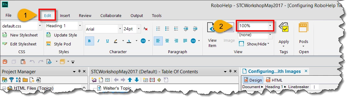

If you text isn't wrapping at the edge of the topic pod, you might have set the zoom level. I can't tell you where it is on the ribbon, but look for something like View > Zoom and set it to 100%.

It's here in the Ribbon UI.
Cheers... Rick
