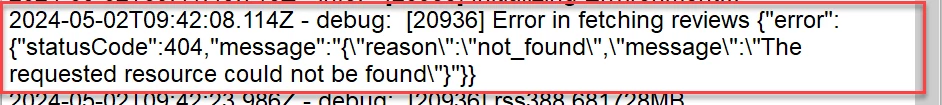

I cannot build PDFs from RH 2022.3.93 - the error message is below.
This occurs regardless of the project or PDF output preset. I have tried installing and reinstalling Adobe Acrobat Pro, but I have had no luck.
Any help would be fantastic as I am in my deliverable generation for our latest software release.

It turns out that my Java 8 installation had been removed. I reinstalled it, and I can now generate PDFs. I appreciate your help.

Was this working before and now suddenly it doesn't? If so, what's changed? If it's never worked, then I suspect something is borked in your install.
May 2, 2024 12:25 PM UTC
It worked perfectly yesterday

I have never seen or heard of this message before so this is trial and error. Try the supplied About RoboHelp project to see if you get the same error. That is a known project that should not throw that error. If it does, then something is wrong with your installation or environment.
  • Is RoboHelp installed to the default directory on your C Drive?
  • See the Before You Start section here. RH2022 PDF Output (grainge.org) I don't think it is related but let's rule it out.
  • Are you generating to the same drive?
  • Is there any source control involved?

May 2, 2024 12:34 PM UTC
Where do I find the About RoboHelp project?
RH is installed to the default location
I am generating to the same drive
I use Git/VS 2019 for source control
May 2, 2024 12:37 PM UTC
I created a dummy project and got the same error so I doubt it is source control related
