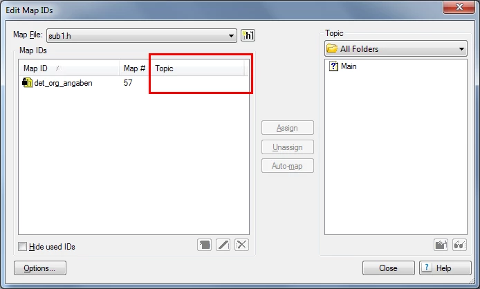

I have built a very simple project in RH9 from scratch, consisting of a main project and a sub-project now after I have modified our large project in changing every hyphens from file and directory names over a couple of days now only to see that context help still doesn't work.
The map IDs are not visible in the main project. To test it in the example, invoke the CSH-Test (context sensitive help test) from the Toolbox, enter !SSL!\Microsoft_HTML_Help\main.chm in the Offline field  and a number 57 in the ID field. In our large project I'm getting nothing (no window pops up). In this example I'm getting this mystical error box, saying HH_HELP_CONTEXT called without a [MAP] section.

I've got a bit further: I solved the problem with the "HH_HELP_CONTEXT called without a [MAP] section".
Reason for this was that the merged CHM didn't contain an #IVB section (use HTML Help Studio from the ToolBox for example). This happens when an ALIAS section is missing in the HHP file I've read here  or when the .ali file is empty as it was the case with me. I put something senseful in there (see my newly compiled RH5 example). This example works in RH5  without having to assign a topic explicitly in the context ID dialog. It solely works by the relations given in the .ALI files.
Now could someone please tell me how this example can be converted to RH9 (working with the alias mechanism)? I think I could make it  working if I knew how the .ALI file would have to look in RH9 (maybe)

If the .ali is empty, that means that your topics are not linked to the context id's, as was also the problem in your example project. As far as I know you will have to link every context to a topic. I'm not familiar with RH5 but when a topic is not linked to a map id, how is the program to know which topic is linked to which id?
You can link the topics by manually editing the .ali file. But only do so if you know what you're doing and if you have a backup!

The example project doesn't work because the map id's have not been linked to topics:
To get the example project working, I simply did the following:
1. Open the map file. (Project Set-up > Context Sensitive Help > xxx.h)
2. Select the Map ID on the left side.
3. Select the corresponding topic on the right side.
4. Click assign.
5. Click Close.
6. Save project and generate.
When I did this for both the master project and the child project, calling the CHM using the numeric id worked.
