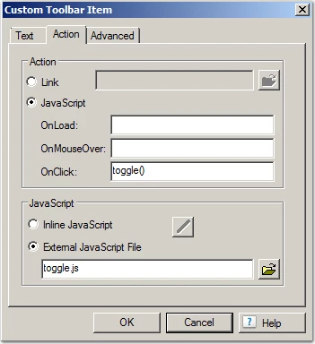

Willam, the PrintTopic() script worked like a charm in IE and Firefox. However, the Expand/Collapse toolbar button script (from the Toggle.js file) still doesn't work in Firefox. The instructions didn't indicate to add the toggle.js file as a dependent file in the "Advanced" tab below - I will try that to see if that does the trick. Per the instructions I indeed added the toggle.js as a baggage file in Robohelp. Do I have an incorrect OnClick javascript action below? Here is the RoboHelp 8 skin setting for the custom toolbar:
Thanks and have a nice weekend,
Dana

Do you use the latest version of the toggle script? Just tested Peter's example project with RH9 and FF8. Get the latest version of the script from: http://www.grainge.org/pages/various_rh_projects/rh8_showhide_toolbar/toggle.js
