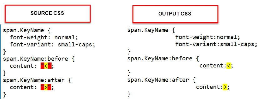

I'm no CSS guru, but I know that the output files are different than the source. My gut tells me that the generation process is causing munging of the CSS in the output. I tested by copying your code and pasting into one of my CSS and applying the style. As you said, WebHelp was fine and the brackets were there but in Responsive they were absent. But when I copied the CSS from the source to the output, the Responsive did actually present the brackets.
When I compared the differences, what seems to be happening is that in the source CSS there are quotations surrounding the desired characters and in the output the quotations are stripped away. So the workaround seems to be to either simply edit the output CSS after you generate or to just copy the source CSS file over and replace the output with it.
