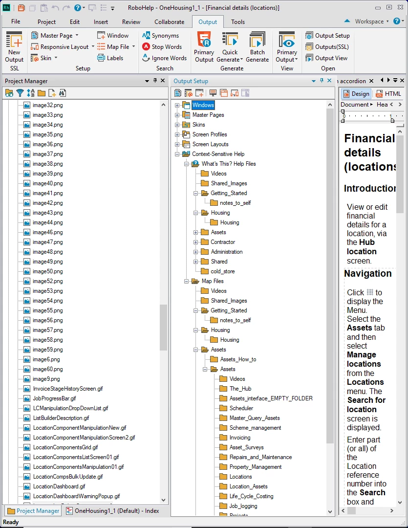

When I open up a new map file in RH2017 i get the following view, which appears to be a bunch of empty folders echoing the hierarchy of my existing help system, but with no actual help topics. What do I do next?

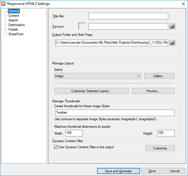

I'm guessing this is the path that appears in the Output Folder and Start Page box, in the Responsive HTML5 Settings dialog shown below.
I add parameters shown in the table to define the type, size and behaviour of the help window/s

That screenshot looks like you're producing old CHM help, not HTML5 Responsive help - with the HTML5 layout, you should see something like "Map Files" and "All Map Files" listed (and that's it).

Not sure about this. Im definitely producing Responsive HTML 5 help. (Indigo) I have been for about a year.
Have I somehow managed to open up the wrong "Map file" panel? Is there some preliminary activity I should have completed or settings I should have made elsewhere?

Within the Context Sensitive Help folder, as well as seeing the folders in your project, you should see further down the H files which is where map IDs are created. You can either use the default or create your own and then give map ids to whichever topics will be called or to all topics.
Your developers then use the map ids by adding them with their code. Alternatively they may give you a list of their screens and tell you to set up the IDs they have set. You then apply that ID to topic that screen needs to call.
