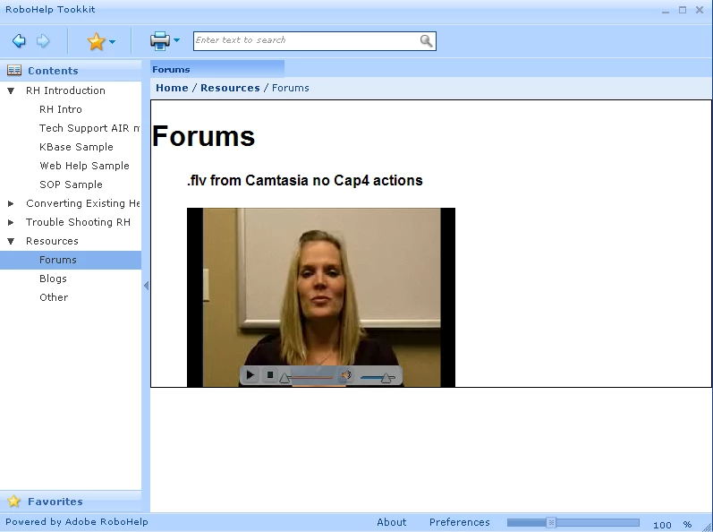

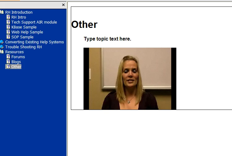

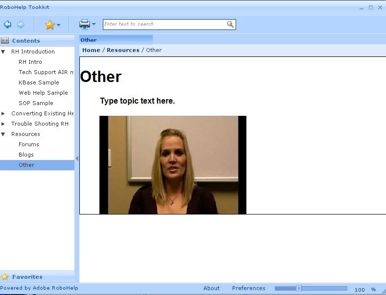

    I have followed this thread and today did some testing on my systems. Cap 4.01 1658 RH 8.02
    First, I had a need to make a sim for my RH toolkit project.  I made the sim in Cap 4 and inserted as a "Adobe Captivate Demo"
    Results, Sim worked witb no problems in AIR help. Note that sim appears in Multimedia files but not baggage.
    Next, I took a 2nd sim that we did last week. This one has a video intro made from Camtasia as a .flv
    Here is where some weird stuff happened.
    1. On the first try, the system imported the halo.swf playbar (part of the .flv from Cap4) but loaded the wrong .swf for the main sim. (I had added 2 initials to the end of the sim containing the .flv to keep the original intact. The sim did not play the .flv (obviously)
    2. Deleting the wrong .swf (w/o the .flv) and re-inserting the correct one did not work either
    3. Next, I went back to the single slide version of the video which I had outputed as .swf not flv. That worked in both Web and Air Help
    4. Finally, I went back to Camtasia and output the infro as an .flv which I imported directly as a "multimedia" demo not a Captivate demo. That worked also in both web and AirHelp
    5. Note that the .flv/swf are in the Multimedia folder(filter) and not in the Baggage folder (filter). I snagged the PM pod but I can't add the snag to this post. Honest, not in baggage only in multimedia!

    Thanks to your post, I did some more investigating....I got it to work!
    In Camtasia Studio 7, there was no option in the Studio Production Wizard to generate an .flv file. I finally stumbled on the "Flash Options" button in the "Custom Production Settings" that let me generate an FLV without the recommended method of embedding it in an HTML page! It gave me a warning not to do it, but I did it anyway! ... and the resulting FLV fiile worked when I imported it as a Multimedia Demo as your post suggested.
    This is all very new to me, so thanks for replying and encouraging me to revisit this.  I still don't know why this method works.
    And, I don't know why each type of Production Wizard in Camtasia outputs the files that it does for each option.  Specifically, it also output a controller.swf along with the FLV I requested.  I did nothing with the controller.swf.  I just imported  the FLV into Robohelp and generated the AIR. Wish I understood more.  But, for now... it works.
