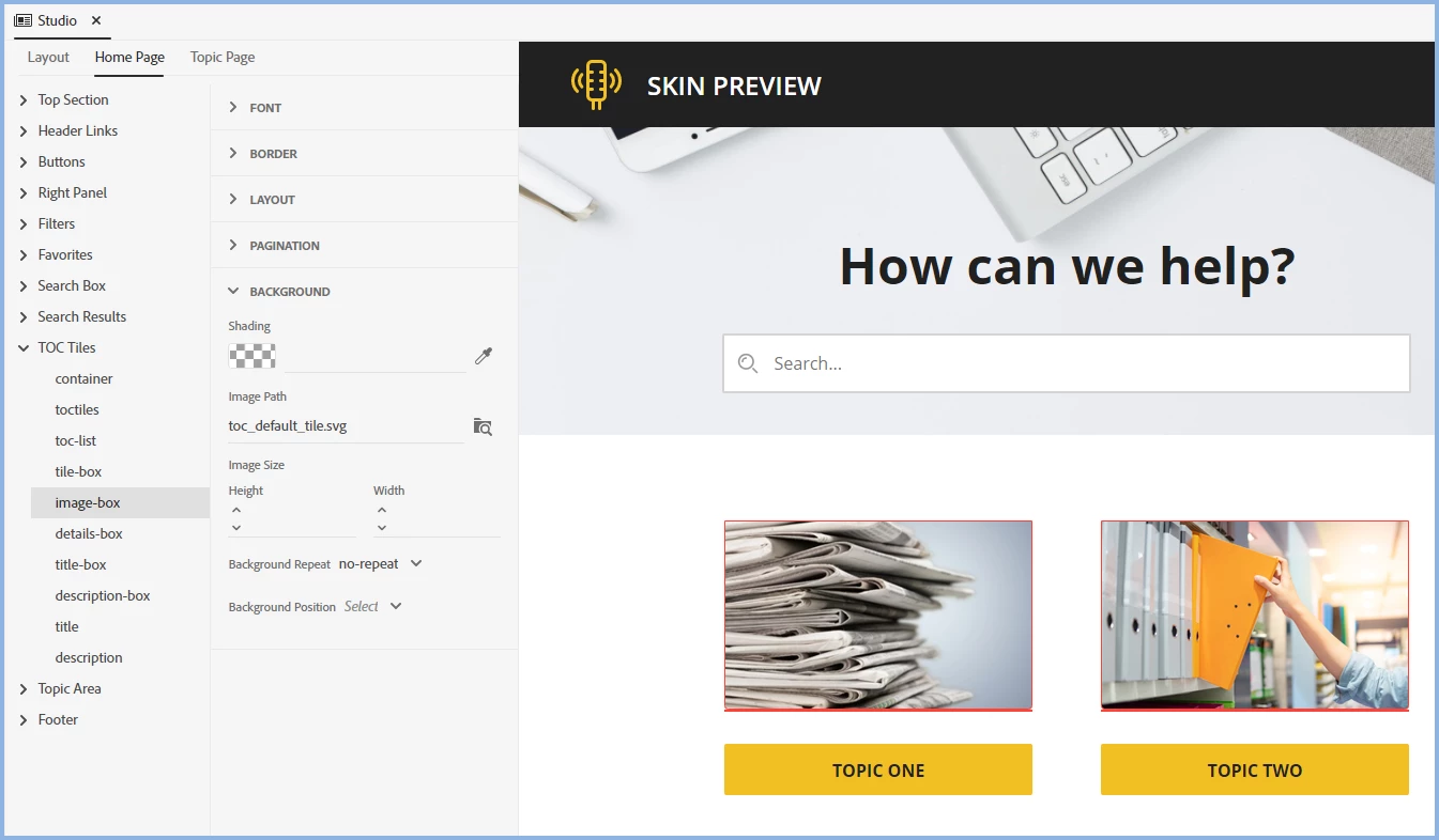

Hi All,
Is it possibe to play around with tiles of the Home Page, frameless Studio,  to do any of the following:
  • totally remove the  tile image (the larger image above the name of the Topic), so the text of the Topic is just displayed
  • Put an image behind the tile title (name of Topic)
    • I'm thinking of a solid arrow or any other solid image
    • and remove the larger tile image
  • Just use a different image for each tile, the image has the name of the Topic
    • I'd have to delete the generation of the Topic name
Thanks in advance!

    You need to go into the template editor.
    You can delete the image but that alone will not remove the space it uses. You can however reduce that using the other configuration options, You can also set a background for details box. By default it will repeat within the box but you can also set that to No Repeat.
    I strongly recommend that after you make a change that works, duplicate the layout before you make further changes. That way you can go back to a good version.
