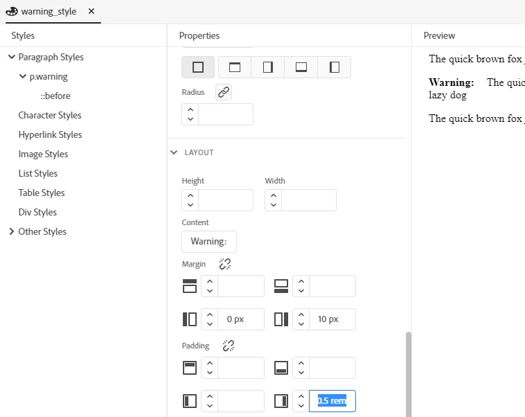

I am wanting to create four paragraph styles in my RH2019 (Version 10) project. Each style is to be autonumbered with text:
WARNING
CAUTION
TIP
NOTE
I create a new paragraph style and in the Autonumber pane for the properties, I set the style to None, and the format to the text, for example, WARNING:.
When I apply this style to text in a topic, I do indeed get the expected autonumber, and then I can add the appropriate text after the autonumber. However, I want the autonumber to be in bold, and I want to decrease the space between the autonumber and the following text. Where can I adjust these properties for an autonumbered style? Because it is not a List style, but a Paragraph style that I am creating, I do not see these options. I don't want to have to create a List style to be able to accomplish this task, but. . . .

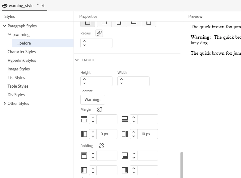

February 11, 2020
It might help to think of the auto-number setting as splitting the paragraph into two chunks: one chunk for the number and one chunk for the rest of the text. Normally the number chunk is just big enough to fit the number. The padding-right says "actually, I want my number chunk to be bigger, and I want to stick the extra space on the right-hand side".
Peter Grainge
February 10, 2020
Amber is probably in bed by now. She's in Oz.
Change it and you will see. 🙂
If you go to the page below you will see an explanation of margins. There is also a test it for yourself button.
https://www.w3schools.com/css/css_margin.asp
Immediately below is the same thing for padding. With content within a border, it's easy to see how the two work.
In your case, you are working with an Autonumber setting that is valid CSS but it introduces another complication. Both margin and padding impact the gap here so earlier it was in fact the total of the two. When margin was set to zero, the total was just the padding setting.
You can comment out any line in CSS by adding /* before it and */ after it. Do that with the padding setting and you will see there is no space at all between the two.
That's about as clear as I can make it. 🙂

Spectrum Writing
February 10, 2020
Thank you Amber, but I will be the first to admit - I am still a relative CSS newbie. What does the right padding setting have to do w/ the gap between the auto-number portion of the tag and the text of the tag?

February 10, 2020
To remove the extra space, go in to the p.warning::before style and remove the padding-right value. That's why you can't make it any smaller than a certain value.
