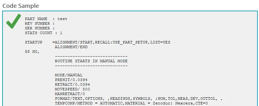

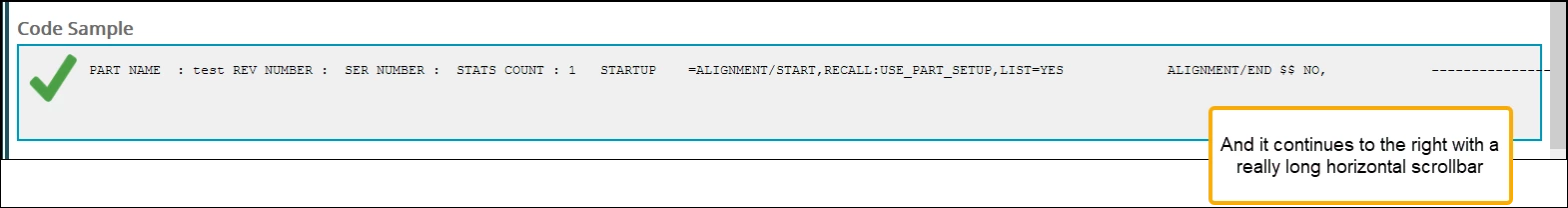

I'm using RH 2017 (13.0.2.334). I'm running into an odd problem. I have a fairly long code sample in a topic. In the generated output (Reponsive HTML5), RoboHelp is often putting everything in the code sample on one line when I click on the topic from the search results.
It looks really bad, like this:
However, when I click on the topic from the TOC, or use the Next / Prev buttons to arrive at the topic, it looks fine, like this:
The problem occurs only when clicking on the topic link from search results.

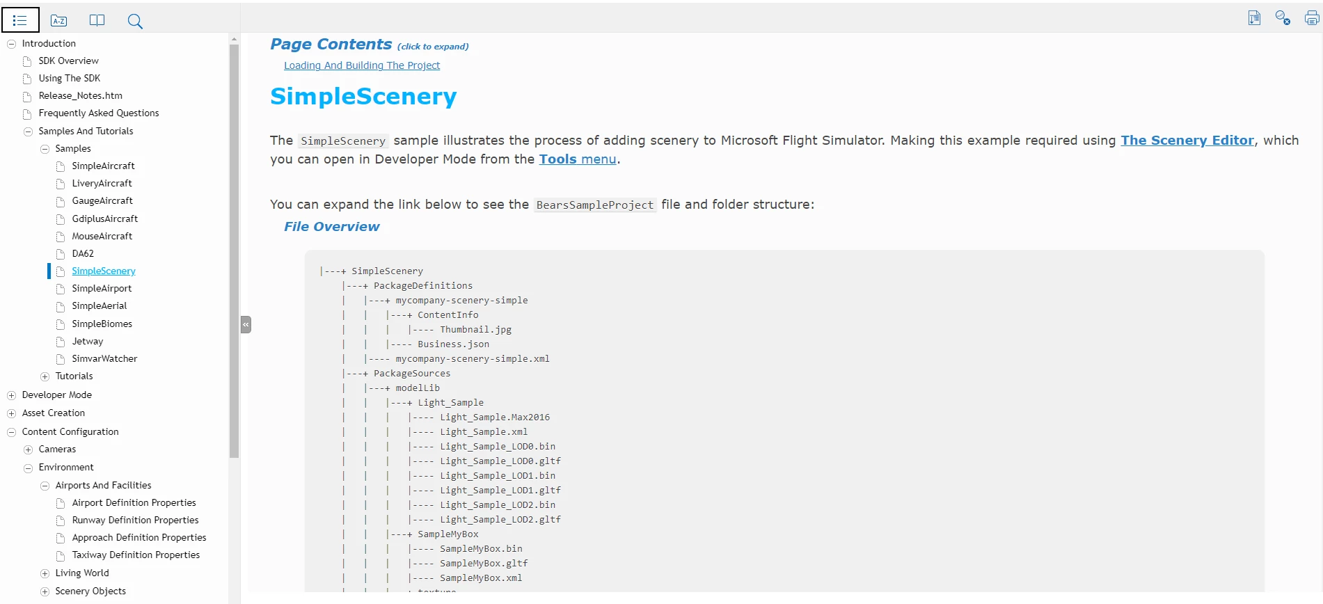

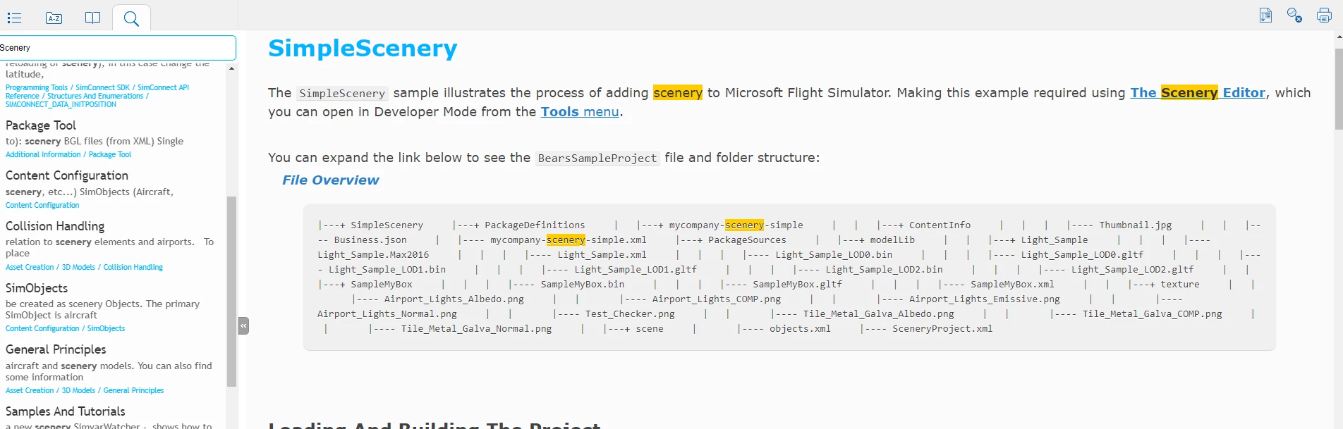

    After seeing this thread, I thought I'd do a quick check as my current project is very code-heavy...and I'm having the EXACT same issue 😞
    Here's the same page but without using the search term:
    So I would say there is definitely a bug here with Robohelp itself.
