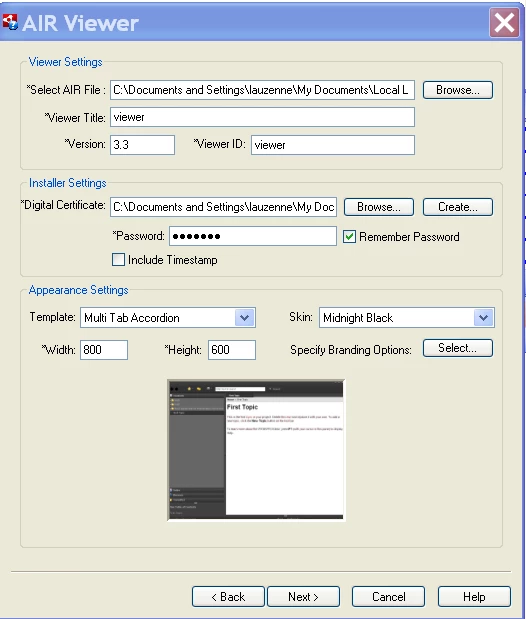

    June 25, 2010
    Hi Sammy,
    I was able to successfully follow your steps to view a single AIR app through the viewer. I can't get multiple AIR apps to appear in the viewer and I think I've isolated the problem to your below step 2.
    "2.) Create the "combining" document as an AIRHelp file using RoboHelp  HTLM 8's Help Viewer Wizard."
    Questions:
    1. Can you please elaborate on how you created the "combining" document using the Help Viewer Wizard?
    2. Which AIR Help file did you select when creating the viewer using AIR Viewer Wizard?
    Lydia
