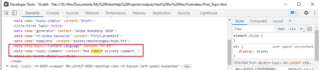

    Be aware that if you use the topic description, that text is in the output and I don't think there is any way to exclude it. While it does not show up in a search as long as you don't select the output preset option Peter mentioned, you can view the website code to view that text. It may be available to search engines if the help is public and may appear in those search search results, although I can't test that (perhaps @Peter Grainge has some on his website he could check.)
    Here's a frameless output, viewing the output code to show my text from the topic description field.
    (In the dim, dark past there was a private comments field which at some point was made public. From memory they had to add a checkbox to the output settings because the change made a whole lot of private documentation notes public, causing a lot of consternation for the authors. This might have been before Adobe got the product, but I can't remember the exact timing. At least in New UI it's been renamed Topic Description so it's a bit more clear it's not private notes.)
