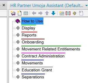

I am trying to use conditional tags to get filters to work in the output. It seems this only works with books or topics added directly into the merged project, not the merged project item in the toc, even though RH allows me to apply a conditional tag to the item.
In the generated output, the only filter that works is the one attached to the How To Use book.  None of the other filters work. My goal is to be able to create filters that would let users select "sets" of books for their needs.  Should this work, or am I pursuing this the wrong way?

Tags can be applied to whatever is in a TOC in a single project so I am guessing that the code for that does not exclude references to child projects. In a single project, all that applying a tag to a TOC item does is exclude it from the TOC, not from the output. The topics can still be found by searching so I'm thinking they can still be found by the filtering code.
Apply your tags or expressions to the topics in each project instead.

Thank you both...  I think it was related to inconsistancy in the application of tags in the parent and merged projects.

I've just started evaluating this in a trial of RH2017 (build 1) and I can get it to work on merged outputs. The thing that tricked me up is the "filter condition tags" must be included in the "Available tags" box of the build expression. (Which makes total sense, otherwise all your topics will be excluded, but sometimes I'm just not that bright )
I also made sure to have the same tags and same filters set up in the parent and each child project.
e.g
Conditional Build Tags pod: P1, P2, P3, exclude, notes, SomeTag
Build expression Available tags field: SomeTag, P1, P2, P3
