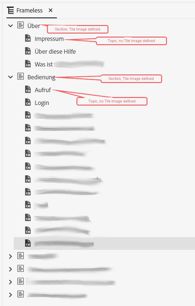

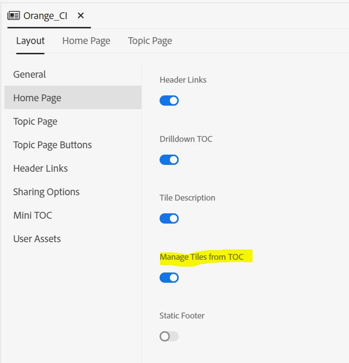

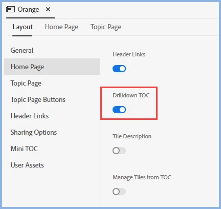

    Peter is definitely right about the Drilldown option. If this is not selected, you'll only get tiles for the first level. If it is selected:
    - you will get tiles for as many levels as there are images for, as long as the images are defined for a folder (section in the TOC) or topic (page in the TOC).
    - you will not get tiles for bookmarks that have an image assigned.

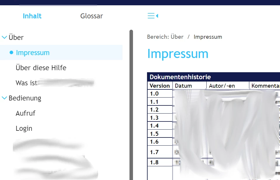

    - so: first level = tiles, if tile is clicked (and this tile is a folder / section) the next level of tiles will open. If tile is clicked (and this tile is a topic), you will get the content of this topic and the TOC.
    So, by using "Manage tiles from TOC", you can control up to which level you want to drilldown the tiles. If you use the skin tiles, all levels will be tiles until you come to a topic.

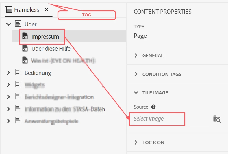

    The image you are pointing to is for a different purpose. See RH2022 The Table of Contents (grainge.org). TOC Tiles can be controlled from the TOC using that field.
    See RH2022 The Table of Contents (grainge.org) > Online TOC Properties > Tile Image.

    to display more than one level of tiles, you just have to assign images for the other sections / topics in your TOC as well. Everything that has an image assign, will be displayed as tile, everything else, not.

    if the requirement is what Amber suggests, I believe this can be achieved by the following:
    In the skin, active Drilldown TOC (otherwise, only the first level will be shown as tiles, in this case Products) and Manage Tiles from TOC (thus being able to define tiles for Products and Sections, but not for Topics).
    Then define images for all Products and Sections in the TOC used for the output.
    This should lead to the following:
    Products shown as tiles - click - Sections shown as tiles - click - all content opens with TOC shown to the right, first topic of this section opened.

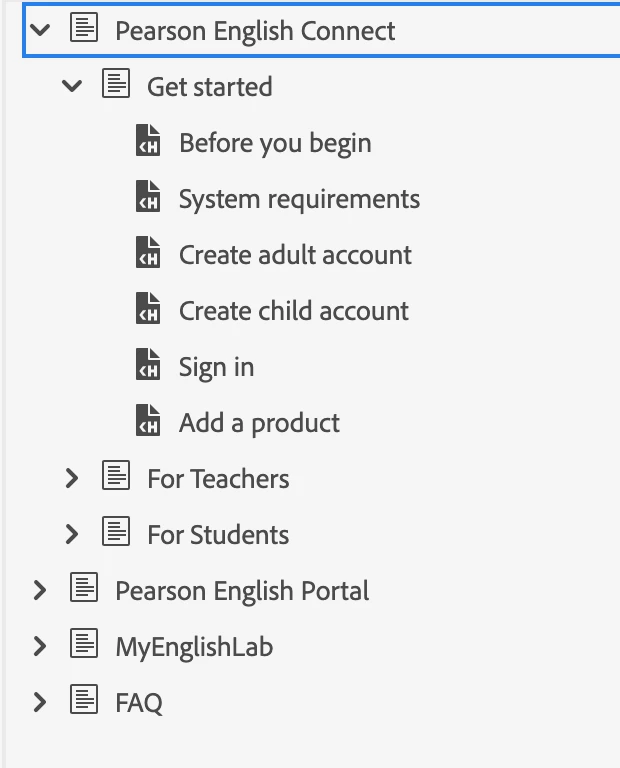

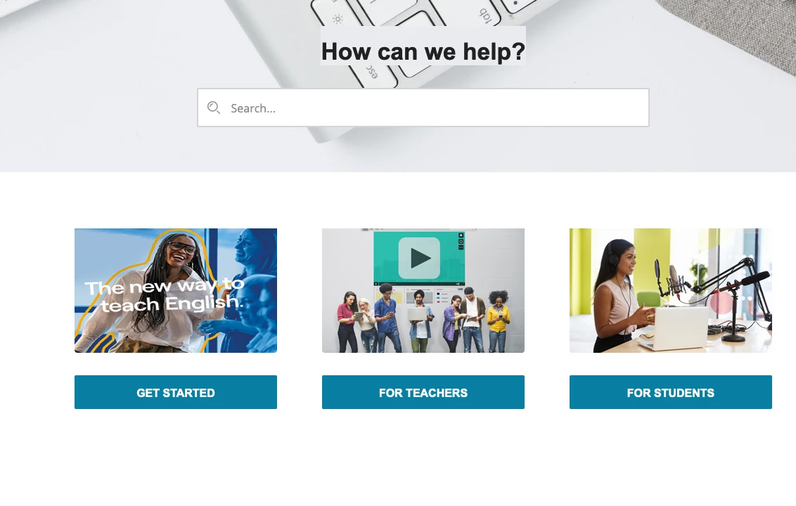

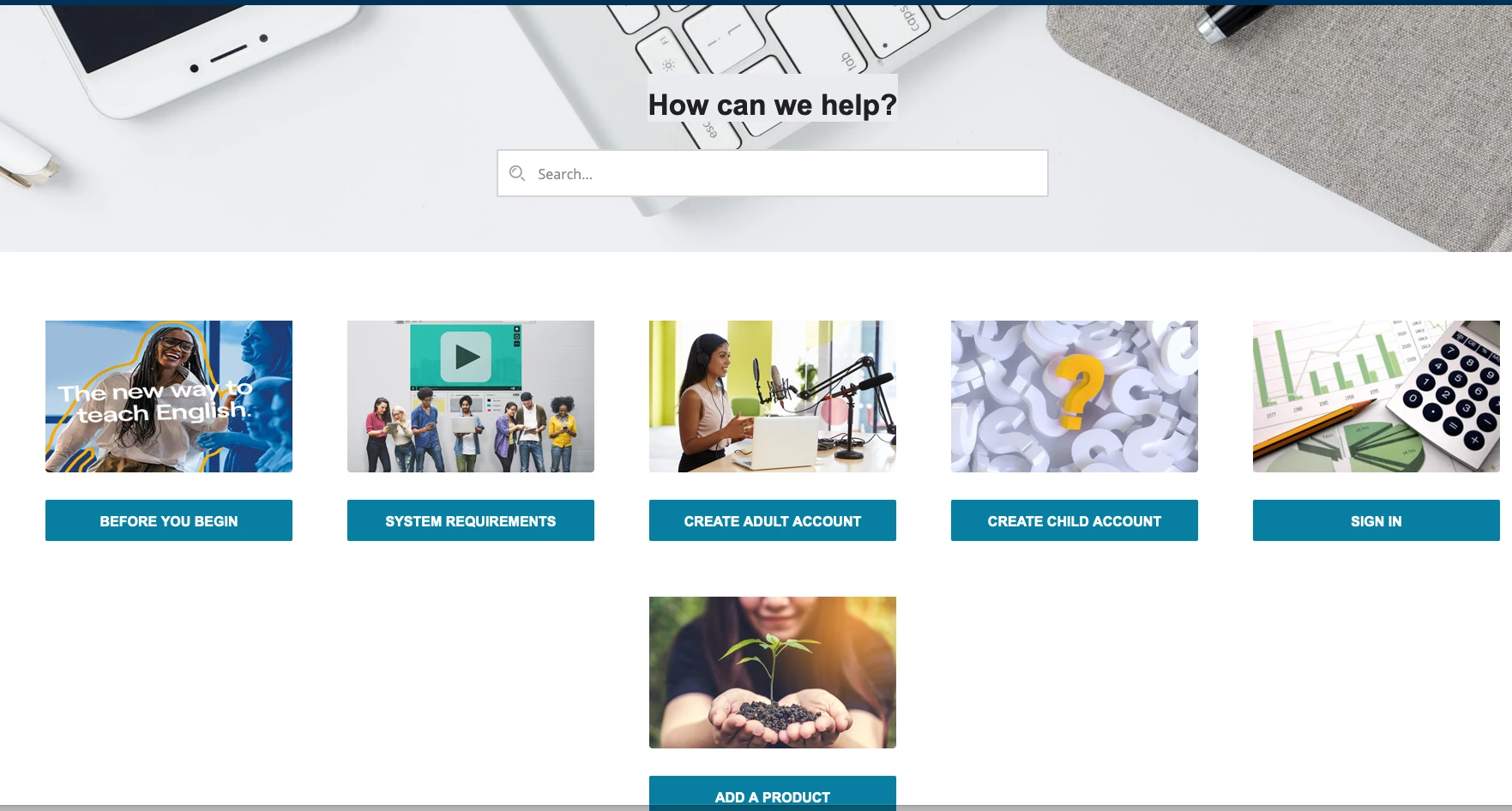

    In my project, I have the following TOC structure:
    My homepage looks like this:
    Clicking on a tile opens this:
    It is no problem to include one more level of tiles in this scenario. I just ran a short test.
    Kind regards
    Karin

    The issue is its structure. If your TOC has Product names at Level 1 and Section names at level 2, then your topics within the level 2 sections, you will get the Tiles for each Product when the help is opened. Then with Drill Down TOC selected in the skin, on selecting Product A you will see tiles for the two sections within. On selecting one of the topics within, it will open and then you will see the full TOC.

    • If they are then the Products would be the first level with the Sections as the second level and both can go to tiles. I think that can be made to work.
