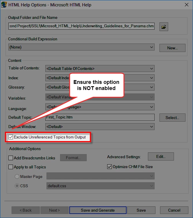

Are you certain the CSH topics are ending up inside the CHM file?
I ask, because when you generate a CHM, you have the option to exclude any topics not referenced. And it occurs to me that CSH topics may qualify if they are only called by the application.
In your SSL recipe, ensure this option is not enabled in order to change things.
Cheers... Rick
