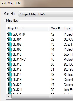

For each project, I noticed that when I went to check my Map File, some Map ID's had topics assigned, while others seemed to have lost their assignment during the conversion (example below):

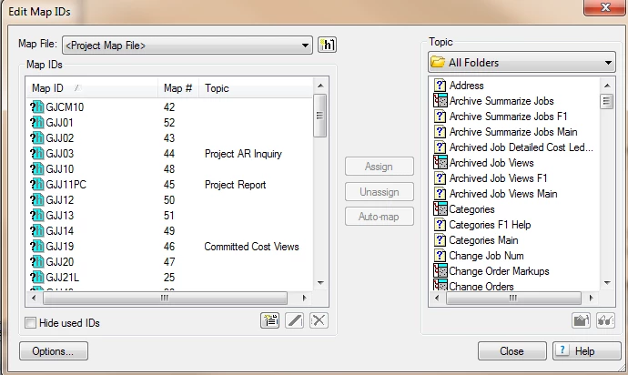

I noticed that if I exited RH10, then went back in, they system found all the 'lost' Topic assignments automatically:
