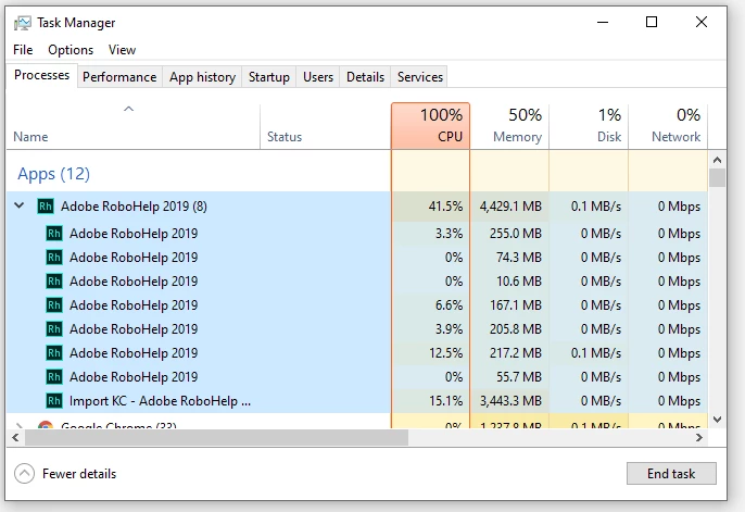

I'm going to do some testing with importing files and seeing if that solves the problem. My boss is reluctant to share our project as is for an internal site. We are talking with our internal Adobe SME right now, but if she can't find a fix I will reach out to Adobe IT. Thanks for all your ideas! I've attached a picture of my task manager when it's trying to open our RoboHelp project. If someone has any idea what these different processes are trying to accomplish it might help to highlight where our issue is.

If it is not please take a screenshot showing RoboHelp using the resources and insert it in this thread using the camera icon.
