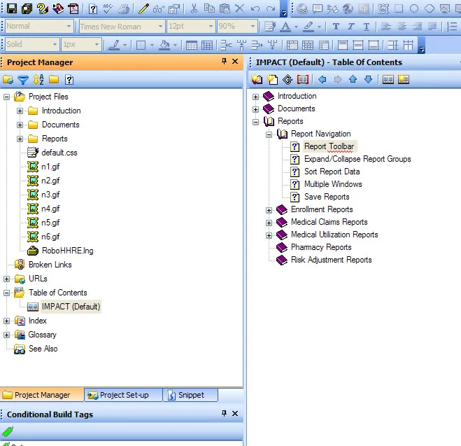

Basically I have five areas in my application and a help icon in each area.  For Example, when the user clicks on the help icon in a certain area, I'd like the Help to open up and display the help info pertaining to that subject.
In the screen capture image I have attached:  I'd like an HTML link to direct the user to "Report Toolbar" under "Report Navigation" under "Reports".

April 28, 2009
OK. Now I understand. What you want is called "Context Sensitive Help". This requires you to produce a map file in RH which basically adds a unique identifier to the help topic that is called by the application. One of my blog posts covers the basics from the RH side. Click here to read it. as far as the application call is concerned, this depends on a number of factors. For example the:
  • Output type (CHM, WebHelp, etc).
  • The application language
If you can let us know the answers to the above, we can point you further in the right direction.
