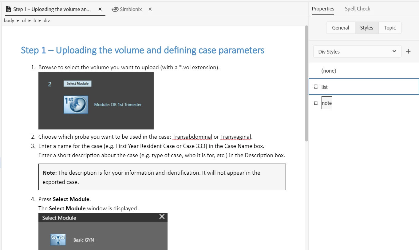

Creating list continue style
I created a new style that would indent under a numbered list or bulleted list item (used for aligning pictures under the text of the list item or the result text under the list item). I put the style in the Paragraph styles (p.list.continue) and Div Styles (div.list.continue). However, selecting it as a div style doesn't format as it should and as a paragraph style doesn't even appear in the Topic Style panel.
The only way I could make the text or picture format as formatted in the style was to work in the source code. For example:
<li>Enter a name for the case in the Case Name box.
<div class="list">Enter a short description about the case in the Description box.</div>
<div class="note"><strong>Note:</strong> The description is for your information and identification. It will not appear in the exported case.</div>
</li>
This kind of defeats the purpose of having a user-friendly, easy to use application if you have to work in the source code especially if someone doesn't know HTML.
Does anyone know away to create a style as described above and to make it work correctly without using the source code?

@Judy I didn't mention anything about a div style? I just suggested removing the dot from the style name as I think it has a special meaning. So create your style as p.listcontinue (without a dot between 'list' and 'continue'.
Mar 31, 2020 11:34 PM UTC
p.list.continue isn't a normal style name. Remove the  dot between list and continue and see if the style now shows up for paragraphs.
(I think the dot is valid but indicates two separate styles applied to the one p tag - I'm assuming you didn't intend that and I would avoid that for the moment as I'm not sure if RH is currently designed to handle it.)

Yes, you are correct about having to numbering restarting with the div style and I did have to manually reset it each time I used the div style.
I will try the paragraph style for the list continue and see if it works.

I'm doing exactly what you're doing, except with p tags instead of div tags. Otherwise the numbering restarts. One other option would be to create a p style that has its own numbering and only resets with specific other p styles. I haven't had the time yet though to figure this out completely. So indeed, since the gui doesn't support extra elements inside a li tag, it's source code city for me as well.

So the lines "Enter a short description about the case..." in point #3 and "Press Select Module." in point #4 is what you're talking about?

Mar 31, 2020 1:51 PM UTC
Can you post a screenshot of what you're trying to accomplish? I haven't heard of many people having to work in source code view to deal with lists.
