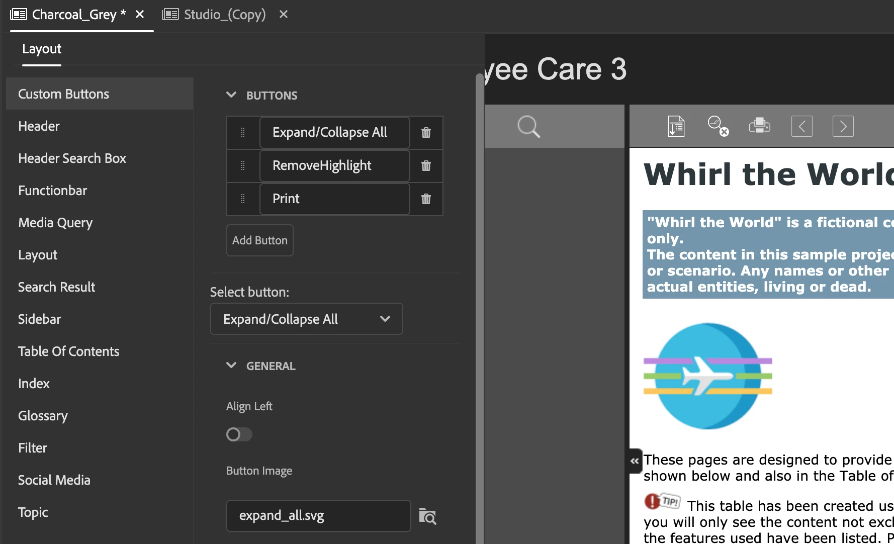

I am using Robohelp 2020 version and want to customize it as per the screenshot below. Can someone suggest where I can make changes in Skin for output to look like as shown in the image?

    You are using a Responsive HTML5 skin. You will get far more customisation options if you use a frameless skin.

    Apr 14, 2021 8:46 AM UTC
    As per my project requirements, I need to have responsive HTML5 only. Also, it would great if you can help in :
    1. What options to change in charcoal grey so that I can add print button in sidebar
    2. What options to change in charcoal grey to add text "Designed and Developed by" in Functionbar
    Apr 14, 2021 9:25 AM UTC
    The Print button should be there by default in the Charcoal Skin:
    To add this additional text you would probably need custom development of a layout and edit the source code of the search bar there.

    You can customize the Skin of your choice in RoboHelp itself. Open your Project, go to Output > Skins, click the + icon, Choose New Frameless Skin, select a Template (e.g. "Studio") and give it your own name. You can then customize pretty much everything (colors, fonts, icons, etc.). See also the RoboHelp User Guide (Work with skins) for more details.
    Apr 14, 2021 8:33 AM UTC
    I tried doing it. But I don't see this option in my RH.
    Under the User Assets drop-down section, click Add Asset.
    Apr 14, 2021 8:48 AM UTC
    As Peter wrote, Charcoal Grey is a more reduced, frame-based HTML5 skin. These skins do not have the "User Assets" feature in the layout tab. I also recommend using a "Frameless Skin" which is much more advanced in many ways.
