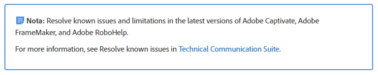

Hi everyone,
I have RH 2022.0.346 and I would like to customize a table.
Specifically I would like to obtain rounded edges with a thick edge.
The final result I would like (I am generating a Responsive HTML 5 output) is that of the following figure
I tried using the table settings like border, radius etc... but it doesn't work.
Can you help me?

    Feb 26, 2024 4:01 PM UTC
    thanks so much Peter!
    I used the code you gave me modifying it as follows
    <table border="0" cellpadding="1" cellspacing="1" tableclass="rounded-corners" style=" width:100%">
    and it works! as shown in the following image

    Feb 25, 2024 11:28 PM UTC
    This note is most likely a div with a border and border-radius set. If you go to where you took that screenshot and inspect the code as described by frameexpert you should be able to find the css and html to set it up. You'll be able to set up some of it using the RH user interface but I'm pretty sure not all of the properties are available as fields, so you'll have to get into the code at some point.
    Feb 26, 2024 8:42 AM UTC
    Thanks Amebr,
    the problem is that I entered the code by inserting the command " border radius: 10px" but it doesn't seem to work
