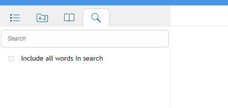

ba84Author
Apr 29, 2021 5:00 PM UTC
Attached a picture to show the skin if this helps.
