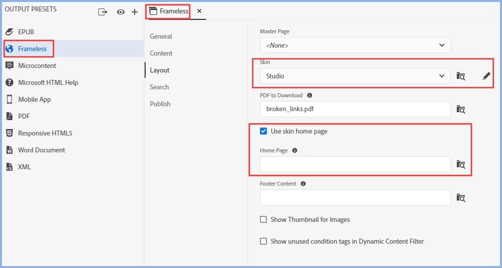

    Peter Grainge
    Peter GraingeCommunity ExpertCorrect answer
    Mar 2, 2021 4:53 PM UTC
    Something is wrong with your information. You have said you are using the Responsive Studio skin. Studio is a frameless skin.

    Mar 2, 2021 4:26 PM UTC
    It's in the preset options, not the skin.

    S4mm1ch35Author
    Mar 2, 2021 4:40 PM UTC
    In the output presets/Responsive HTMLs I do not see the option in general, content, or layout.

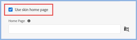

    Peter Grainge
    Mar 2, 2021 3:17 PM UTC
    Are you not seeing this checkbox?
    The Home Page field is for when you want to define your own home page rather than the supplied home page. If that is blank and you deselect the checkbox, you should not see a home page.

    S4mm1ch35Author
    Mar 2, 2021 4:10 PM UTC
    I do not see that as an option in output/skins/studio/layout. Should I be looking soemwhere else?
    Peter Grainge
    Feb 26, 2021 5:03 PM UTC
    I'm not at a RoboHelp machine right now but I think it's an option in the preset. If look at the skin options.

    S4mm1ch35Author
    Mar 2, 2021 2:40 PM UTC
    I see the Home Page in the layout tab, however, there is not an option to toggle it off, so to speak., and I cannot delete the page. I do not see an option in the Home Page tab either.
    S4mm1ch35Author
    Feb 26, 2021 5:01 PM UTC
    I should clarify that I am using the Responsive HTML5 Studio skin.
