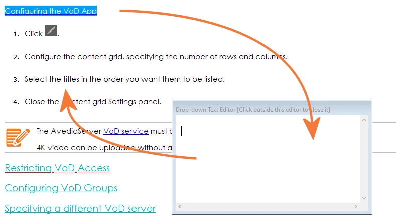

Hi all
I am using RH 2019 and have a problem with some drop down text instances.
Instead of having to click the drop down link, the text is already displayed below the link.
In the source, the drop down is empty - the text I  put in it has moved from the text box to below the text in the main topic.
Other links in the topic work ok. This is happening randomly throughout the project. I've tried comparing the HTML but my head is spinning now and I wondered if anyone else had come across this?
Any ideas much appreciated
Laura

fifelauraAuthor
Nov 7, 2019 10:09 AM UTC
Hi Peter
Thanks for your reply. I have never seen a drop down that looks like the one you pasted - mine always look like the one I posted (and work fine). This is strange....!
Laura

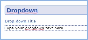

Peter Grainge
Nov 7, 2019 8:57 AM UTC
In author mode the content of your dropdown should look like this, all within the dotted lines.
I am not seeing those dotted lines in your screenshot.
