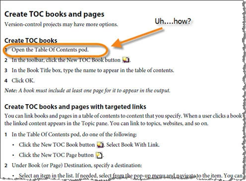

    <rant> Yes, I hope they have this as a bug, or at least something to add as a Help topic. Very unhelpful to have help topics about how to create TOCs where the first step is "open TOC pod" but search as one might (I did for nearly an hour) - nowhere can an instruction be found about how to do that.

    Use the Community Help commenting and add a comment to that topic saying that step one should continue "by double clicking the required TOC in Project Manager."

    Hi Peter - I did this - made a note in the Community Help, and then it was removed as being a 'feature request'. Arrggghhh.... heavy sigh. I tried.
