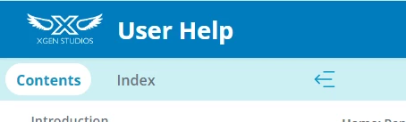

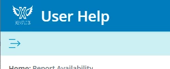

    May 24, 2023 4:15 PM UTC
    Thank you,
    When the browser window is reduced in size to approximately 25% of the screen size or less, the image doesn't maintain its original appearance. I inserted an example logo below.
    Original:
    After browser window is reduced:
    This has happened with both svg and png files. It also occurred in HTML5 output with the Azure Blue skin. The current settings for Header > logo (Oceanic skin) are listed below.
