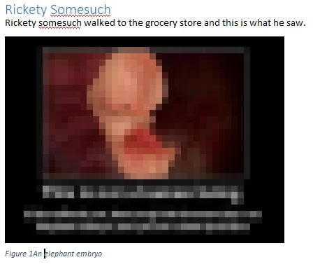

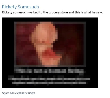

    Captiv8r
    Mar 13, 2015 4:16 PM UTC
    Hi there
    I just tested by adding a figure caption as you stated. Upon import, it came in just fine.
    Here is is in Word:
    And here it is after importing this document in RoboHelp.
    The figure caption arrived in RoboHelp as editable text immediately below the image.
