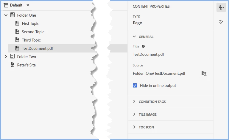

    I set up a project in a folder with the project name.
    At the same level as that folder, I created Outputs\Responsive
    In the project under Contents I created a folder called FolderOne and added a PDF called TestDocument.pdf
    I added that as a baggage file. Note the Hide in online output. That's the bit that saves you having to paste the link into the output.
    I then created a button called Download and set the URL to .
    file:///D:/00_Test_Projects/Outputs/Responsive/Folder_One/TestDocument.pdf
    D will be your local drive so probably C
    I then generated and clicked the button. Worked fine. It will only work on your machine so that you can test. When you create the help further down the line, you will change the URL to a web link to wherever you generate.

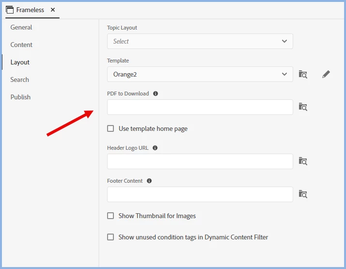

    Peter Grainge
    February 19, 2025
    There does seem to be an issue with this method. I am looking into it.
    UPDATE
    There was an issue with the skin I was using. Step by step this is how to make it work.

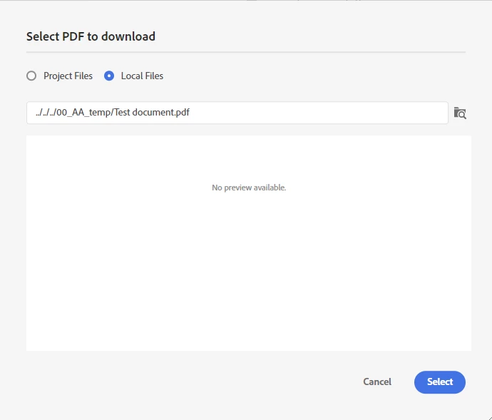

    First create the PDF you want to download. As before, you can only link one PDF for the whole help.
    In the Frameless preset go to the preset and click the search icon, then Local Files (unless you have already added the PDF to your project)
    It will show the relative path but when you click Select, RoboHelp will change that to the Assets > Docs folder and import the file.
    All I did then was generate to my template and click the download icon. That opens the PDF.

    Peter Grainge
    February 18, 2025
    If you add a single PDF where I have shown, the toolbar will automatically include another icon to download it.

    Peter Grainge
    February 19, 2025
    I created a PDF, browsed to it and RoboHelp imported it into Assets. When I generated, the download icon was automatically added.

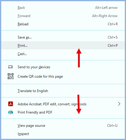

    The Download PDF button is intended for downloading one PDF only, not a PDF for the selected page. Generally this would be a PDF of the whole help. What I believe you want is a PDF of just the page the user is viewing. For that you would have to create the PDF and put a link to it in the topic.
    The only alternative I can think of right now is for the user to right click and then choose a PDF option in their list of printers. That would require training or a note in the topic guiding the user to do that. This way is not very elegant but it is an option.
