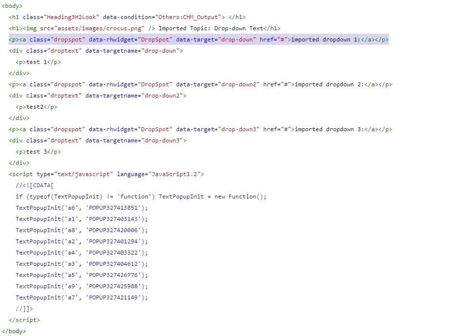

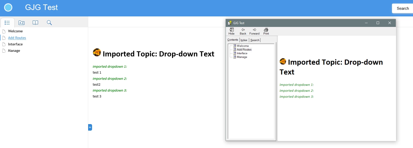

I upgraded a project to RH2020 and in the CHM, clicking the link to open drop-down text had mixed results. Some opened normally, some didn't open at all, and others opened the wrong text (the text for a different drop-down link). I recreated all of the drop-down text links in that topic and now none of them open at all.
  • Robohelp 2020.3.32.
  • The drop-down text works in Responsive HTML5 output in Firefox and IE 11.

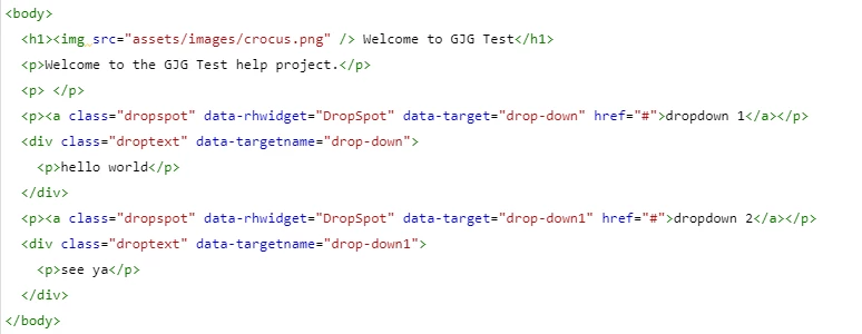

  • I imported the troublesome topic to a fresh RH2020 project and have the same symptom. Another topic in the same project opens the drop-down text as expected.
  • Workaround: After comparing the HTML of the working and non-working dropdowns, I discovered removing the script tag containing CDATA fixed the problem.
I plan to fix my updated project with the workaround I discovered. Recording here for others and if anyone has other suggestions or insight.

    I tried making a fresh project in RH11 and cannot duplicate the problem when I upgrade it to RH2020. I can assume I forgot how the topic was made or something else weird happened.
    So the final answer is try workaround of removing the script tag containing CDATA to fix the problem.
