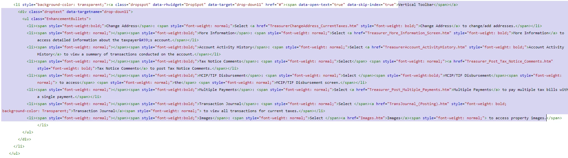

    The only significant difference I can see is the span tag around the dropdown title (Vertical Toolbar in this example). It contains properties data-open-text and data-skip-text. I don't know what they do but "skip" sound suspicious. 😛
    Try deleting that span from one example and see if the dropdown starts working.

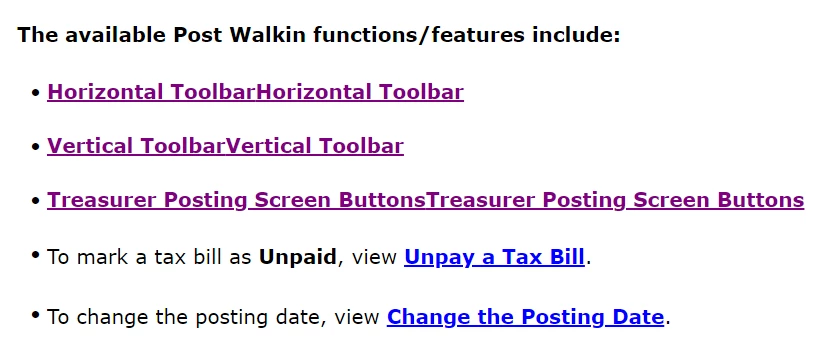

    I tried removing the data-open-text and data-skip-text code and anything else that looked suspicious. After I did that, the drop-down were displaying as Drop-Down Title type in the Content Properties pane, so I thought that had fixed the problem. Nope. 😞 After I sent the generated outtput to IT and they loaded it to the site, the drop-downs looked even weirder:

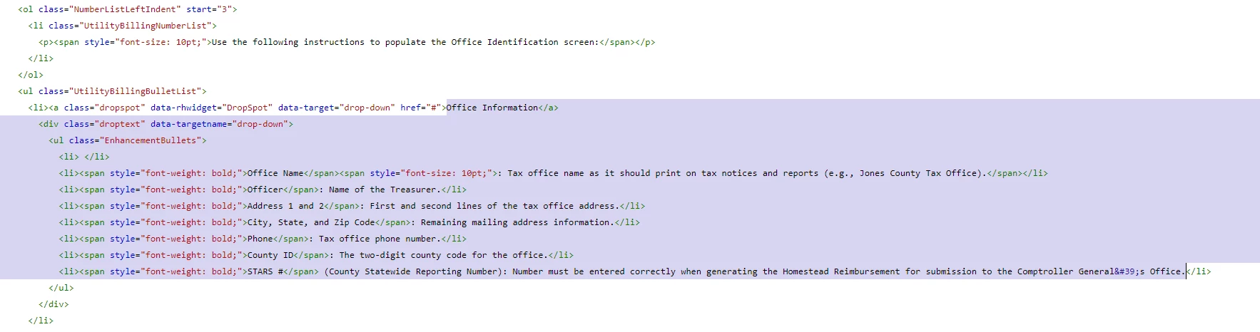

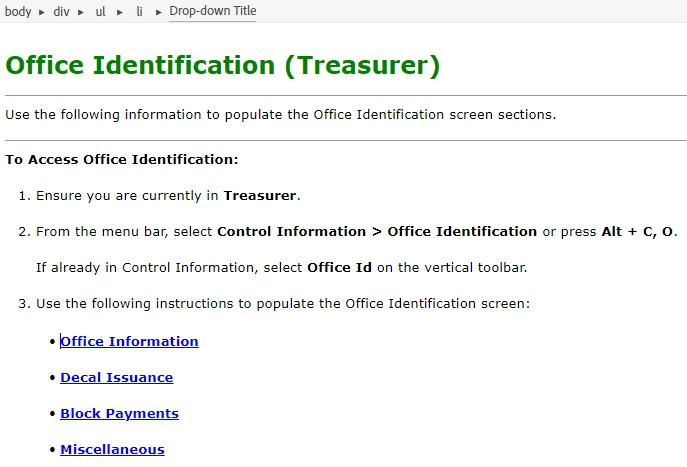

    Can you post a couple of screenshots of the RH editor for a working one and a broken open? First get the regular editor view. Make sure you put the cursor right at the start of the dropdown text and capture the breadcrumbs bar at the top of the tab. Then select the whole dropdown (hyperlinked text and body text) and switch to code view and screenshot around the highlighted code.
    Please use the Insert Photo icon to add the images inline with the text, as it's easier to help when the images and text are visible at the same time.
    Aug 21, 2023 1:11 PM UTC
    Here is an example of a working drop-down (Office Information):
    Here is an example of one that is not working (Vertical Toolbar):
