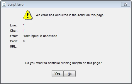

When I use preview and click on this dropdown hotspot, I get an error
If I use View with... IE or FF, nothing happens when I click on the hotspot.
If I select Chrome, the dropdown works as expected.

Your comments led me to do some more testing this morning. I had only gotten to the using the preview viewer in previous testing.
This time I went ahead with the full output build (Webhelp) and the dropdowns worked on all my browsers.
Then I tried again using HTML5 output. Same results.
I also tried making a dropdown in one of the sample projects and then using the Preview.
It worked there, in Chrome, in IE (after I allowed ActiveX content), and did nothing in FF.  Odd.
Apparently the problems only occur when you go through the Preview viewer.
In any case, I've learned not to test dropdowns in the Preview.
