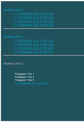

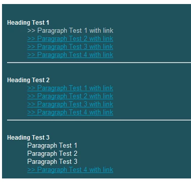

For example:
CHM Footer Text Directly in the .htt:
CHM Footer Text from a Snippet in the .htt:
(Previewed in Ctrl + W, the snippet looks fine)
CHM Footer Text in drop downs in a snippet in the .htt:
I believe the problems here have to do with a combination of CSS specificity and relative sizes going wonky when the content comes together from these different pieces.
