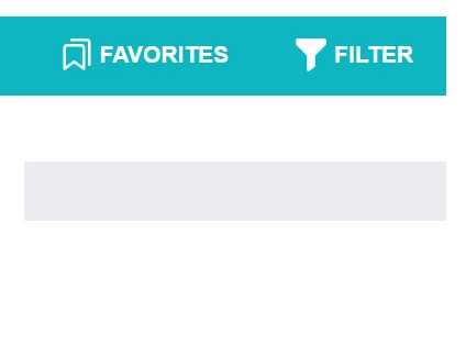

one more caveat to add.  On the topic page, no filters display.  this is what I get when I click on fitler on the topic page:
nothing displays for filters.

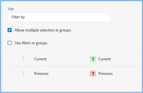

Note the selected check box in my screenshot. Does that change it?
________________________________________________________
My site www.grainge.org includes many free Authoring and RoboHelp resources that may be of help.
Jan 31, 2022 7:21 PM UTC
No, it didn't change it.

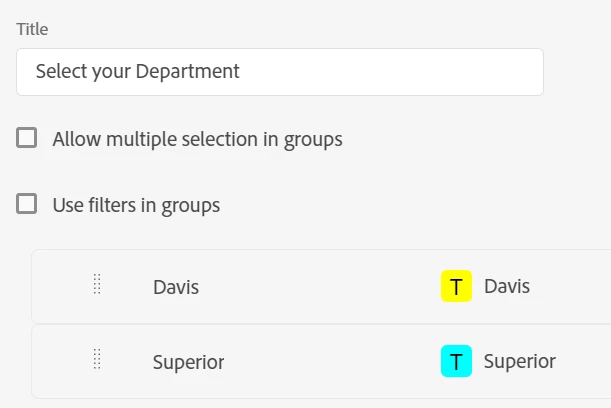

Peter, Yes, this is the first time since training that I'm doing the filter. I've checked the 'compass travel' example but it was built in a previous version. So, following your website (the link you gave above) I did the following:
My filter looks like this:

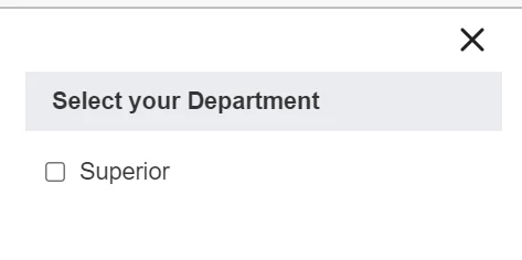

I generate, and view, and this is what the participants see:
They only see Superior, not Superior and Davis.  I do not have either of these set as a default. And, I have topics with both Superior and Davis assigned to them.
Thanks for your help.
