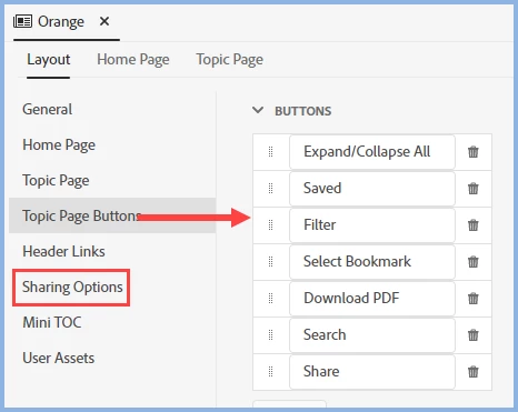

    Most things are in the Skin Editor. You can remove buttons here,
    Saved and Select Bookmark are what I think you need to remove. Create a new skin and check it out there.
    You can either remove Share or limit what is in it by looking in Sharing Options.

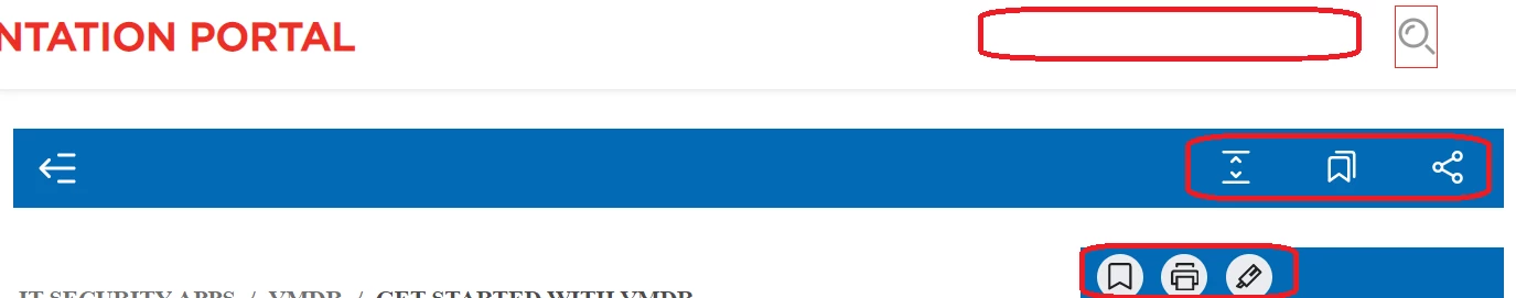

    Please see this screenshot:
    With your recommendation, I was able to remove the elements from the top of the page, near the "search" button.
    But am yet to figure how to remove the 3 buttons (Expand/collapse, Favorites, Share) from the toolbar and the buttons (Set as Favorite, Print, Remove highlight) on the mini-toc on the right.

    Skin > Layout > Topic Page Buttons
    Delete it there.
